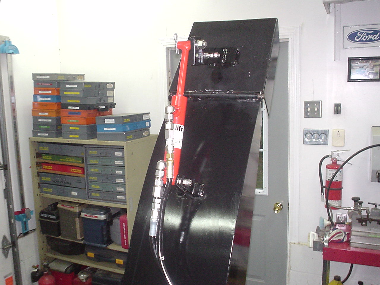

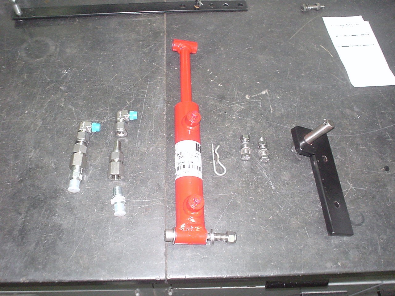

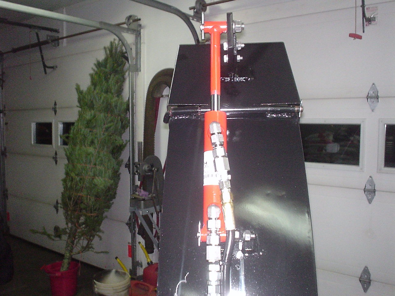

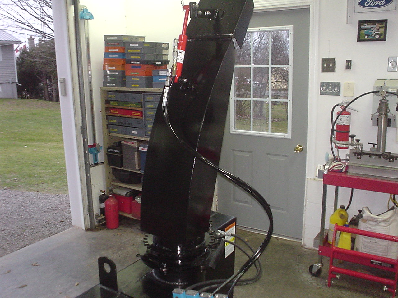

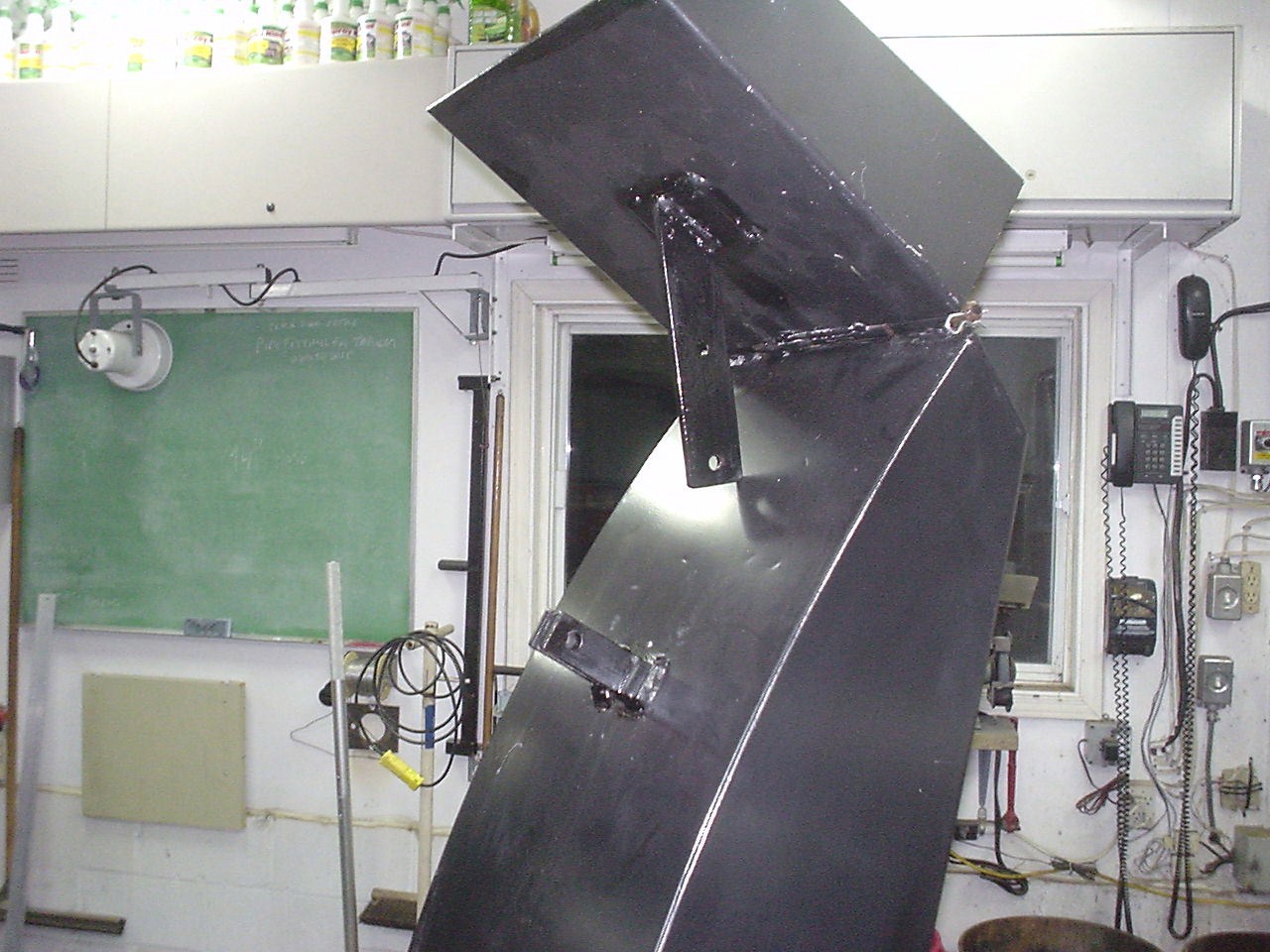

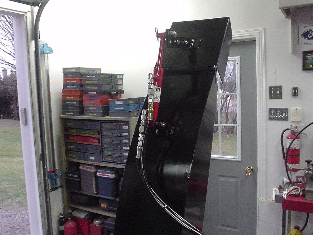

   / What size hydraulic cylinder do I need? #4
Hydraulic chute deflector cylinder mounted 2.JPGHydraulic chute deflector cylinder mounted 3.JPGHydraulic chute deflector cylinder mounted 6.JPGHydraulic cylinder  mounted quick release 1.JPGHydraulic cylinder  mounted quick release 2.JPGHydraulic cylinder  mounted quick release 3.JPGHydraulic cylinder  mounted quick release 4.JPGSnowblower hydraulic chute deflector cylinder, custom made bracket, hose adaptors and connectors.JPGSnowblower hydraulic chute deflector ready for cylinder bracket to be installed.JPG
I bought my cyl. at Princess auto. Smallest one they sell.
Thanks for replying with pictures. :) That is exactly the setup that want.
From the pics it seems you have the the 1" bore x 4" stroke here or the 1-1/2" bore and 4" stroke like in this link. Can you confirm which you have?
How fast does yours move in operation?
You should also ask his flow rate and compare that to your tractors pump flow rate.
   / What size hydraulic cylinder do I need? #7
The first link to the 1 x 4 is correct. I have it hooked up with 1/4" hoses to help slow it. I think the pump is 8.5 GPM.
If you just yank the rear remote lever it moves quite fast, but if you feather it a bit it works fine.
I also have hydraulic rotation but that uses a motor so it is a little slower.
