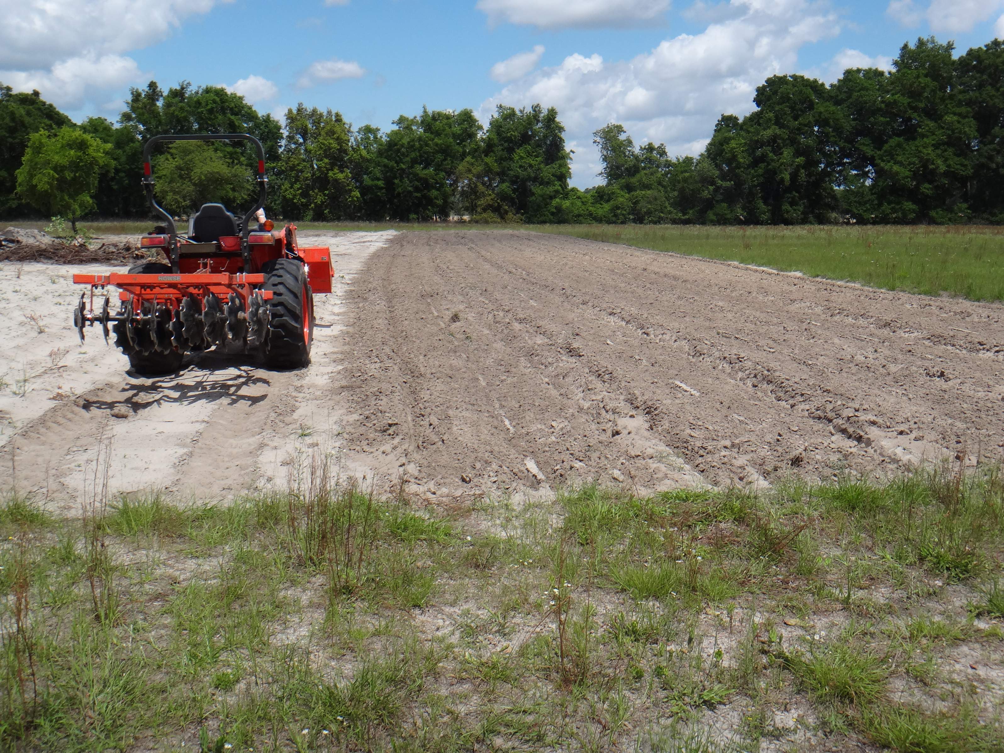

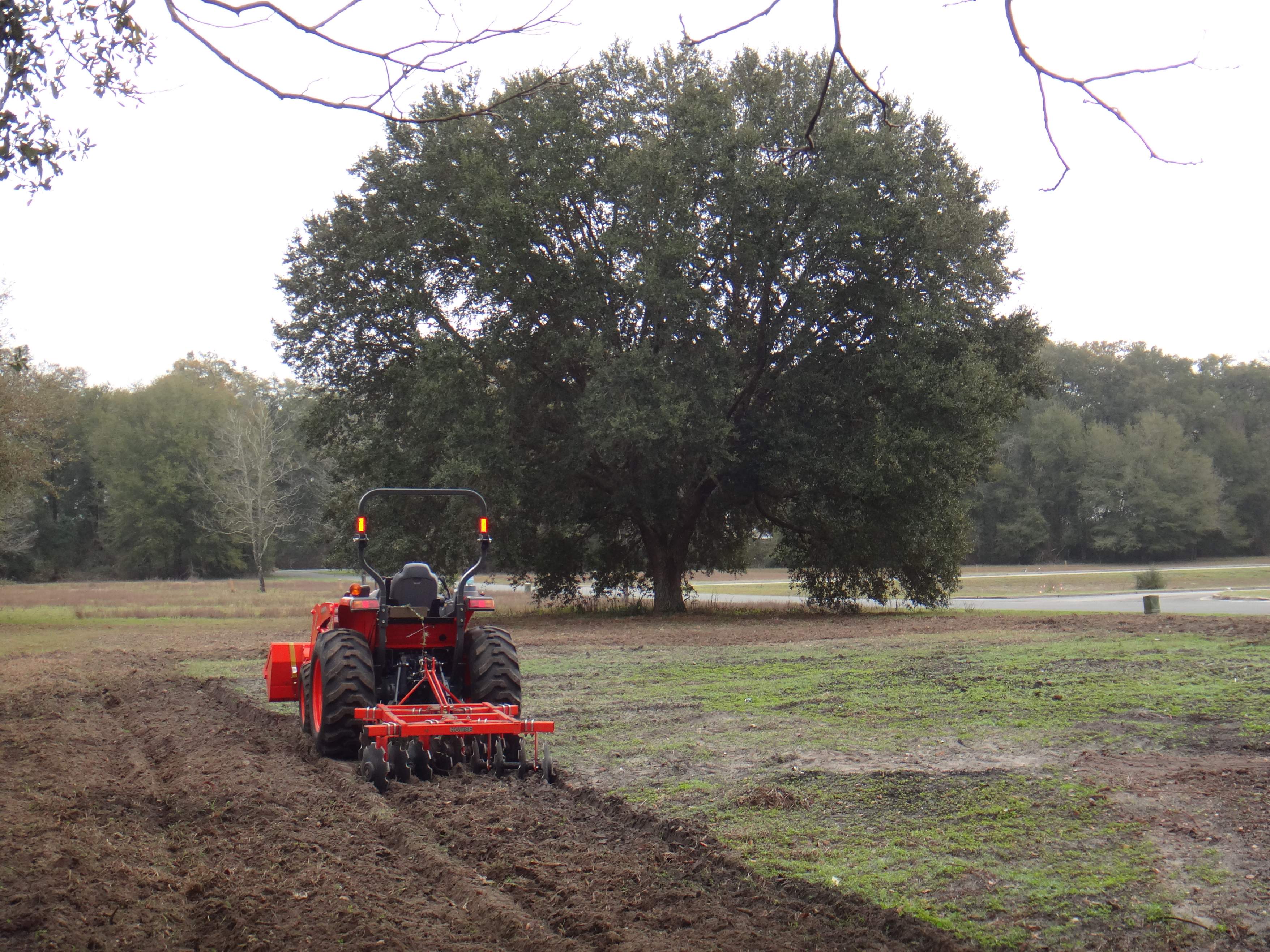

OFFSET DISCS are interchangeable in function with gang plows. They are for opening ground/primary tillage in a single pass. Built very heavy, require considerable tractive power to pull, relative to a Tandem Disc Harrow.
MOUNTED TANDEM DISC HARROWS are more for smoothing and leveling ground, although at about 24" diameter pans in sandy soil, such as you and I share, they work pretty well for primary tillage as well. To level fields over several seasons Disc Harrows must be move over the ground at a brisk pace. Slow just drops dirt back where it was.
I am 100% sure your L39 can pull a Tandem Disc Harrow with 22" diameter pans. I am 80% certain your L39 can pull a Tandem Disc Harrow with 24" diameter pans. (I do not know the weight of an L39 without the heavy duty Backhoe attached.)
Very generally~~~~
~ Better to buy max diameter pan diameter, for good cutting ability, as wide as your tractor or a bit wider.
~~ However, some who disc annually or semi-annually might not need as much cutting ability due to perennially soft ground so would prefer wider coverage.
~~~ For game food plots you want a Disc slightly narrower than rear tread width, so it will pass between trees.
It all DEPENDS........
