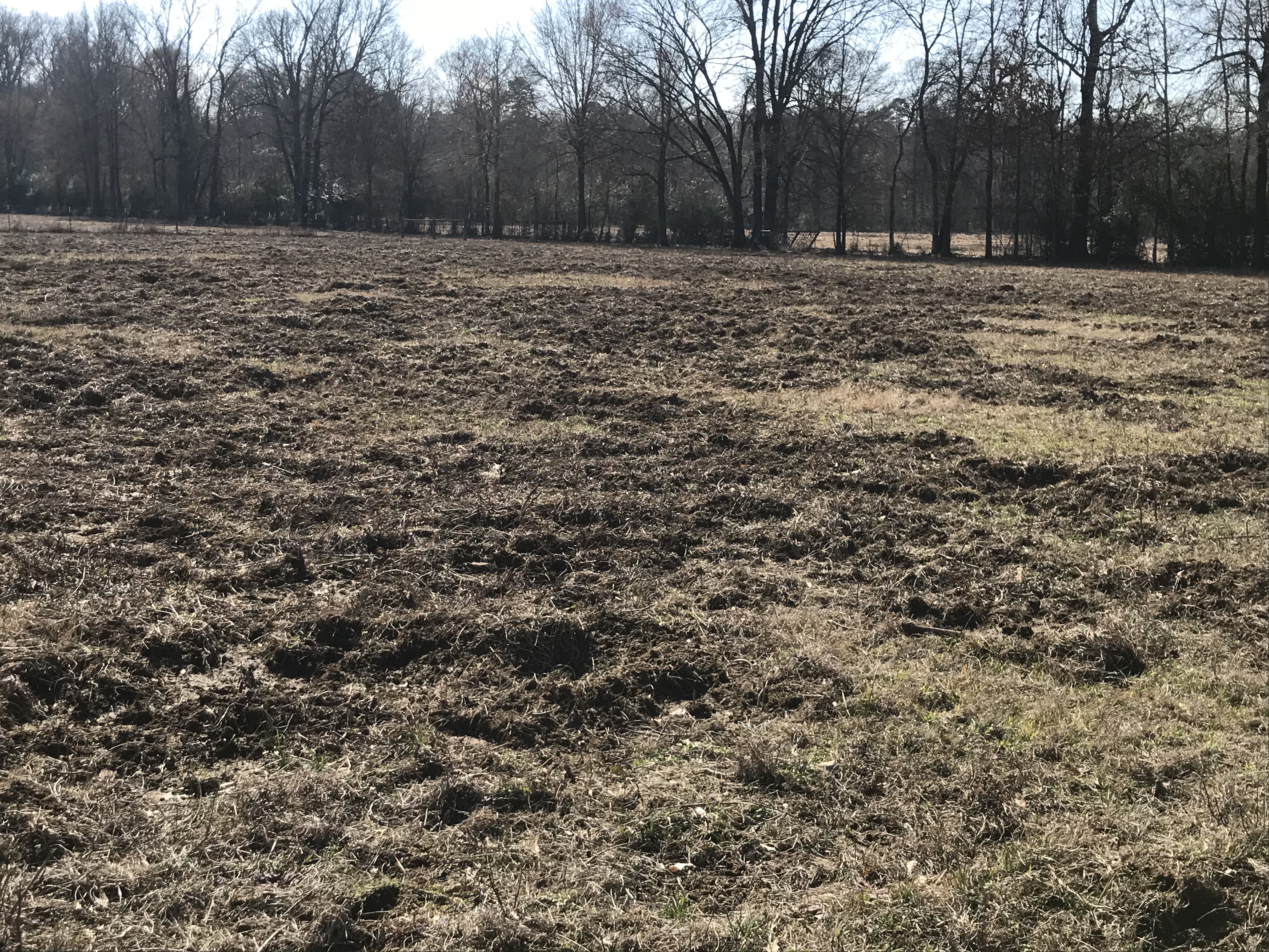

Appreciate the replies everyone. It's roughly 5 acres and pretty good topsoil. Some areas on the farm are a bit sandy. The farm is about 3 hours north of Houston so I was looking at this bush hog 2D7818 but wasn't sure if it was too heavy. Sounds like I may need to look at a tiller. With the depth of some of the holes, I wasn't sure if a tiller would help to level the dirt as it works. The field has gotten worse since this pic but it gives you a pretty good idea of what I'm dealing with. We have started trapping (caught 8 weekend before last) and I now have a thermal scope.

I have 30+ acres that looks EXACTLY like that. I use a 30Hp 16 speed 4WD tractor with a loader. Total combined weight with the tiller, tractor and FEL is just over 4,000lbs. But my 250 sexy self in the seat and a half a ton of rocks in the loader with a 6 foot woods tiller running at 540RPM, even after glyphosate on the sod was just scratching the surface. Sure, I had some descent looking places here and there but I knew something was wrong. And lots of people gave me good advice to no avail. Please take a half hour and call the guys at Everything Attachments. Ask for Jeremy. He put me in a heavy 7 footer that was gear driven. No chain. He told me that if the tiller was "pushing" the tractor forward too much, then take off the outer tines on both sides the first time you till it. Unbelievable the difference that unit made. They know their products pretty good there. Make sure you know the year, make and model of your unit and they'll match you with the right tiller. Guaranteed. PLUS, FREE SHIPPING within 1,000 miles of the Carolina's. Give them a shot. If you don't like them - don't buy. But I'm sure you will. Good luck and Godspeed - BotaTrac Out!

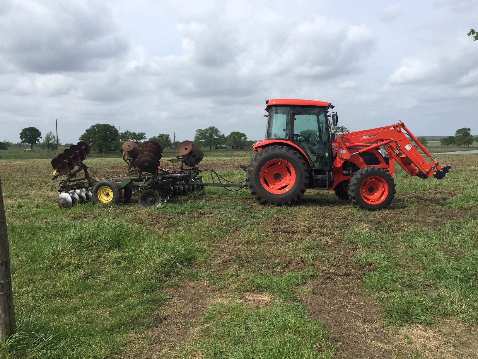

Yep, I run a jd210 transport disc with 32 18" pans. Gangs are adjustable, front is set about Midway which is about a 70 degree gang angle. Rear is backed off to 75 degrees.
If I made it the most agressive I can, it would probably struggle.
I have AG tires, loaded, and 600# wheel weights. In heavy soil, low range about 3.5 mph top speed...don't even know is back there. Trying med range I run out of power if discing full depth. Slows the tractor to the point I might as well be in low range. A gear tractor should have no issues though but you didn't say what tires you have either.
And with 32 pans on 9" spacing....jd lists this as a 11'5" disc.
