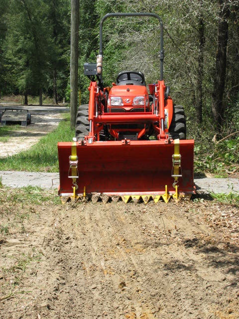

Do you have a Front End Loader on the Yanmar? Consider a Ratchet Rake.
