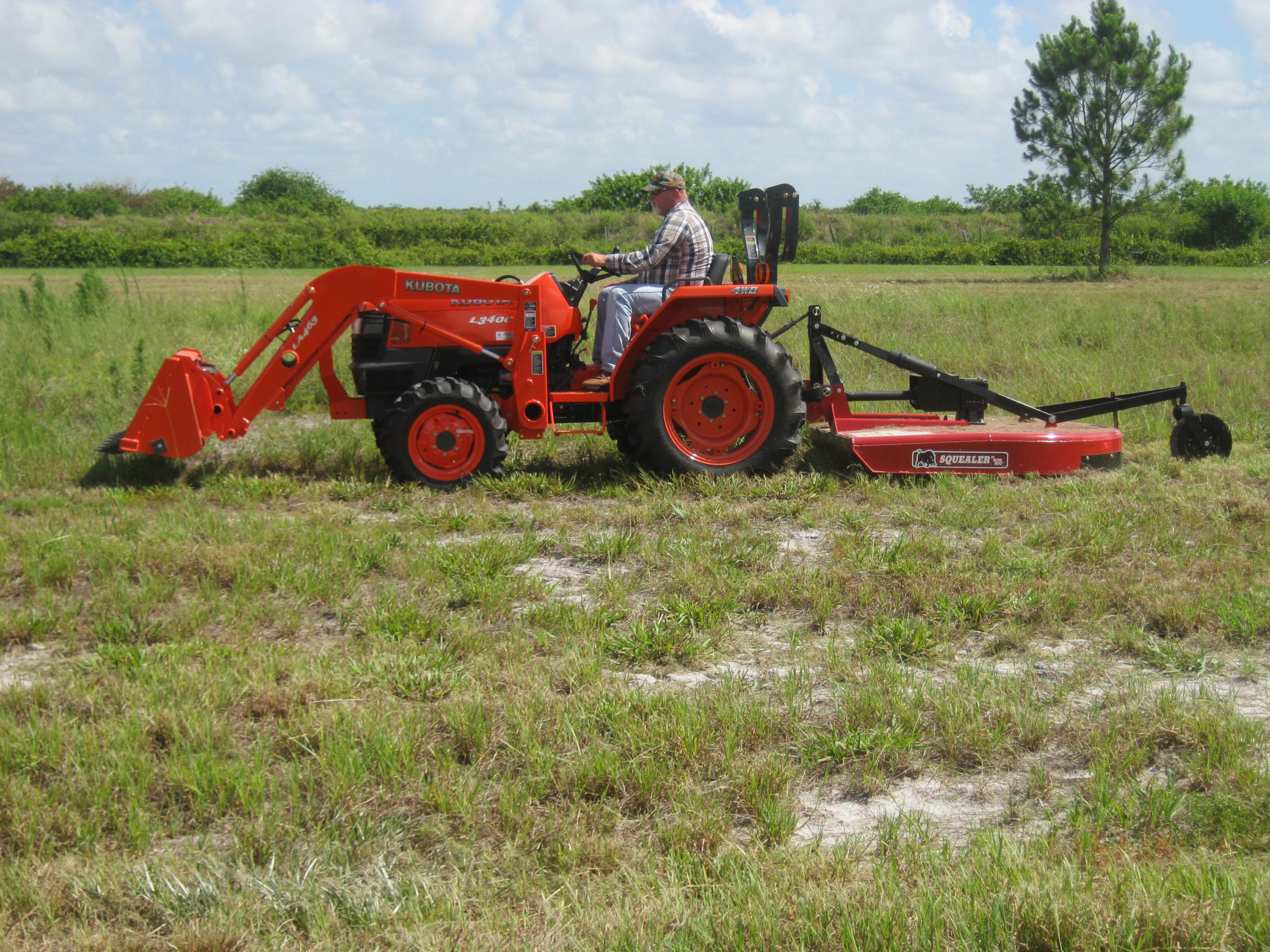

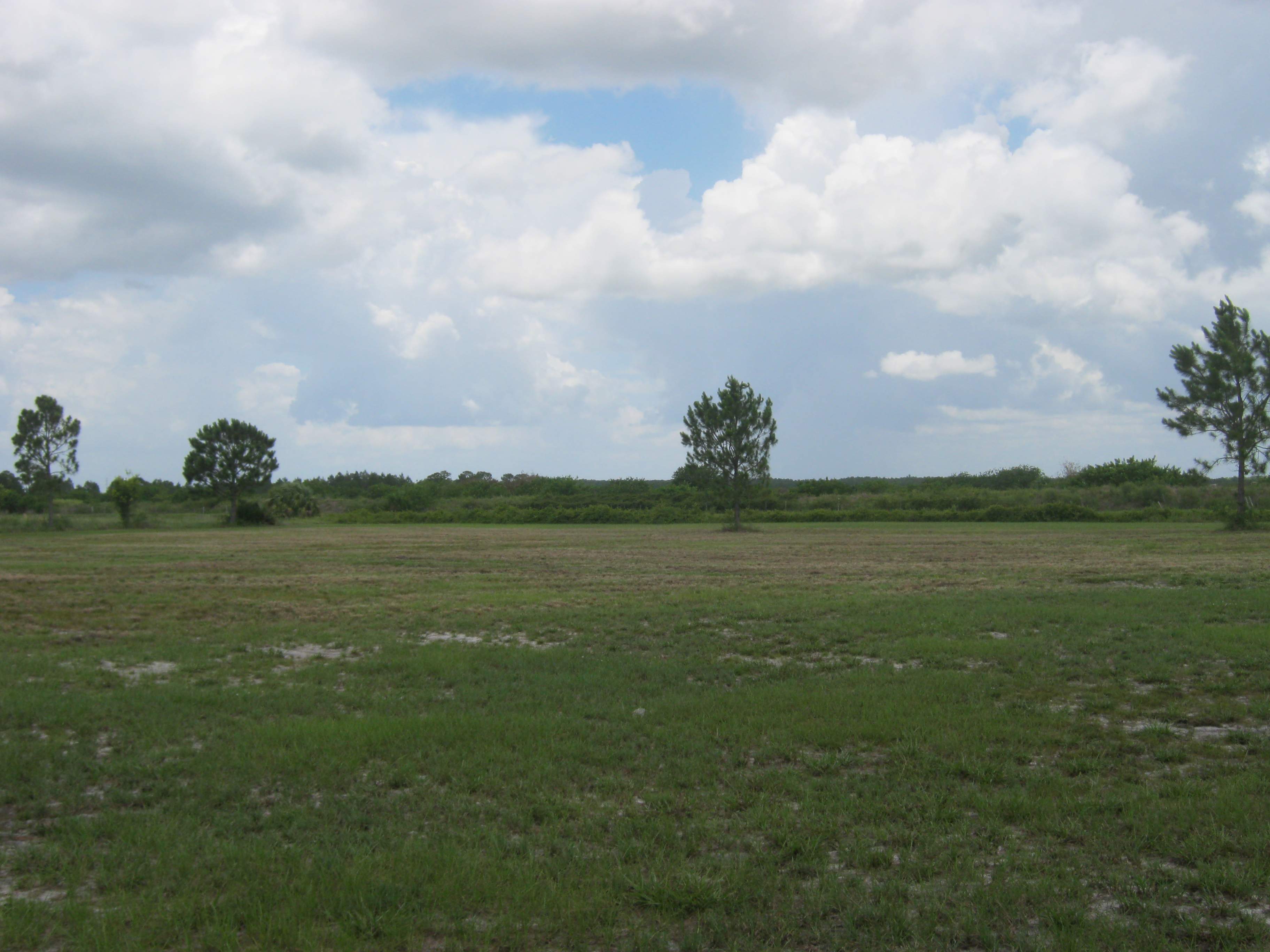

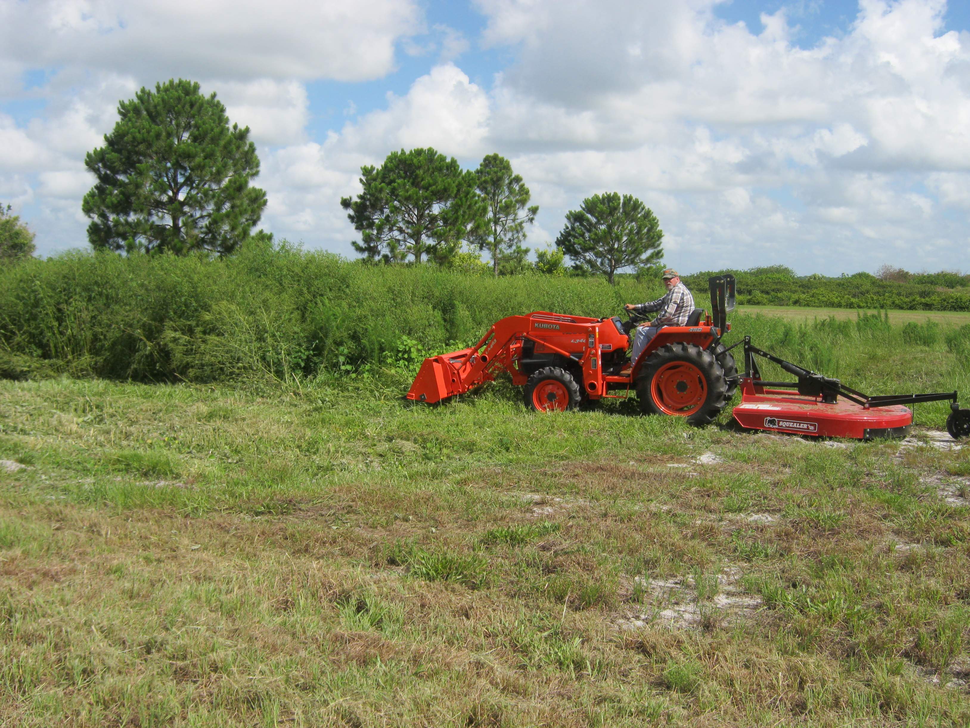

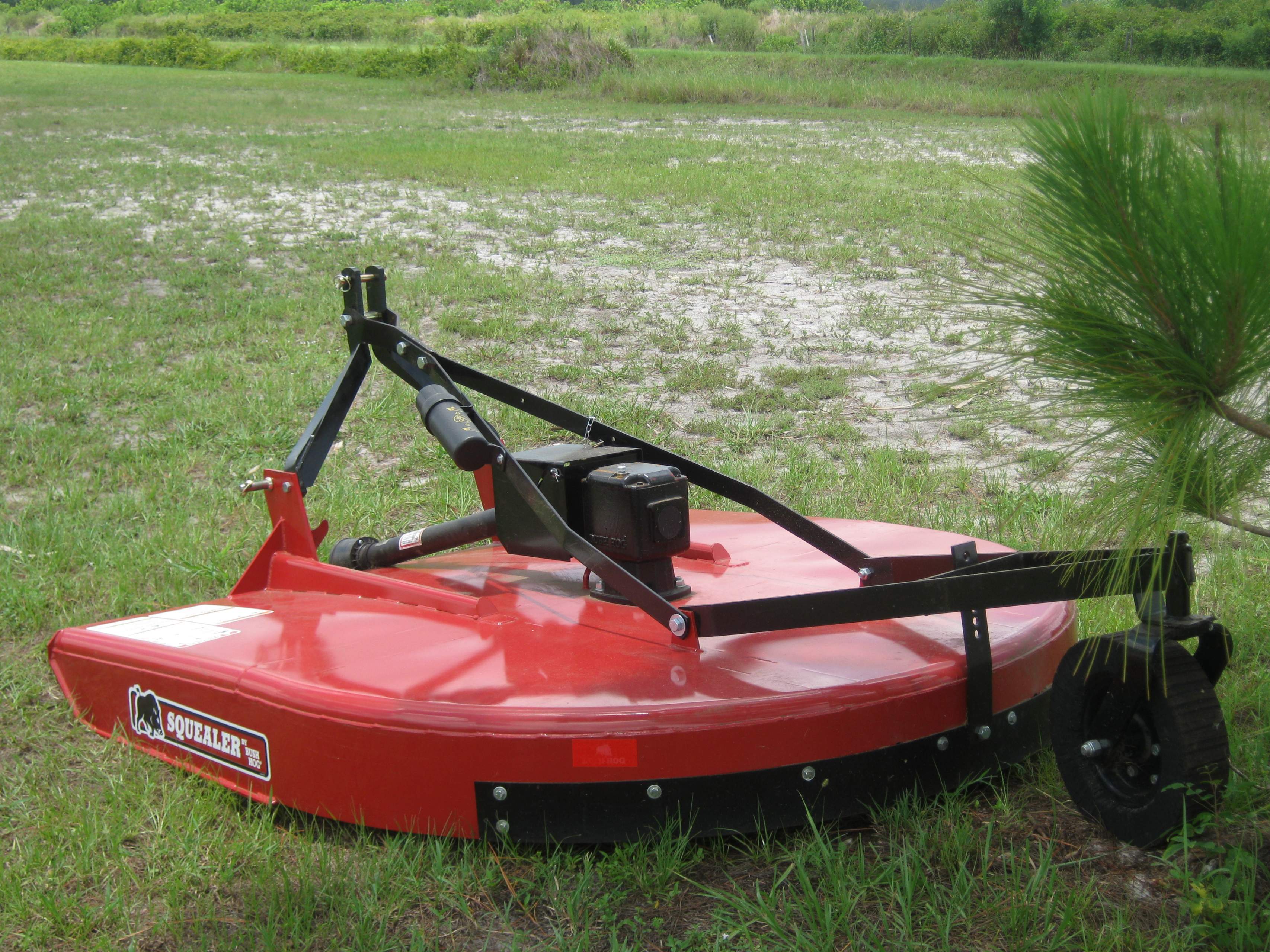

I have a Bush Hog sq172(6') and pull it with my L3400DT Bota.With FEL on flat land and my 255lb.s tractor pulls it like its not even back there(3rd. gear low)2 or 4wd.
Boone
(ROPS down was cutting under/trees)
