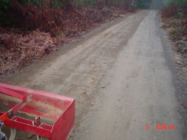

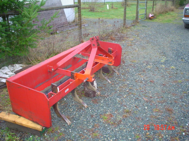

I got a used 6 ft box blade for my CK35, it was used and at a good price.
Best though would have been a 5 ft. If I had to buy a new one it would be a 5 ft. With a box blade I don't think bigger is better. Generally you want one that is just wider than you tires.
