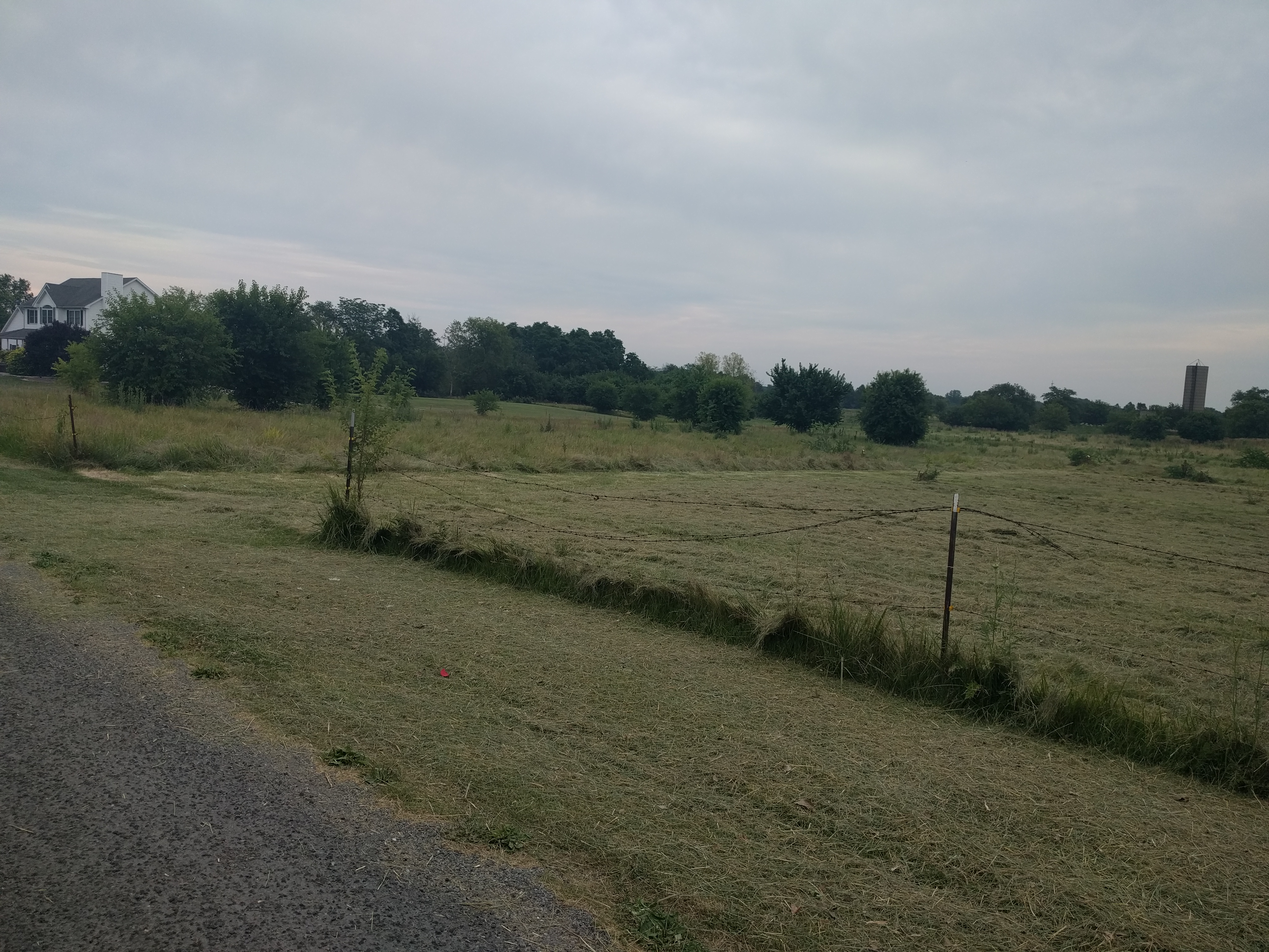

Price Range: 4-6K max
Property Size: 4 acres - Flat
Primary Uses: Brushhog / Tilling / Snow Removal
Secondary Uses: Finish Mowing / Grading / Wagon Rides :)
I've been looking at JD 950 & Ford Powermaster Series. Any others I should be considering?
