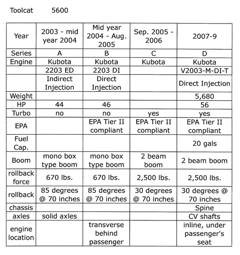

Over time I've tried to compile a little data on the different series Toolcat 5600's and so far this is what I've come up with. If someone has other data or corrections to this, please let me know.
I hope this helps, DEWFPO
I can't change the attachment when I update it so here is a link to the most Updated Spreadsheet : http://i99.photobucket.com/albums/l304/dewfpo/343484eb.jpg
Dewfpo, one little, but very visual, difference that you might add between the 'C' and 'D' series is that the fuel cap moved from passenger side on the C to driver's side on the D.
