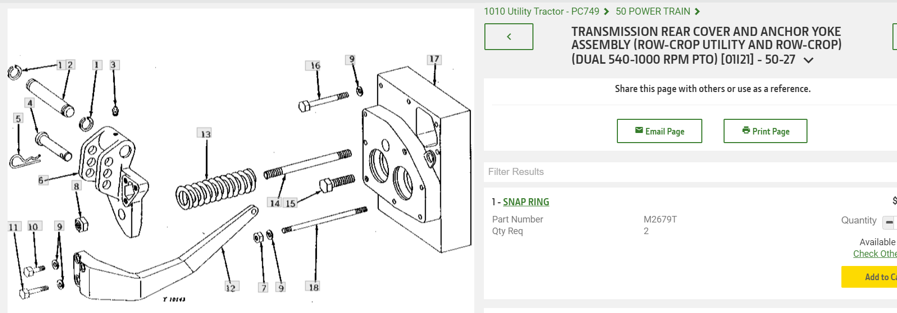

Some older JD tractors such as model 1010 with HP as low as 35 had dual speed(540/1000) rpm pto speeds.
