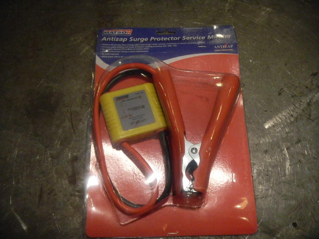

Any vehicle with a computer, you should pick up one of these.
