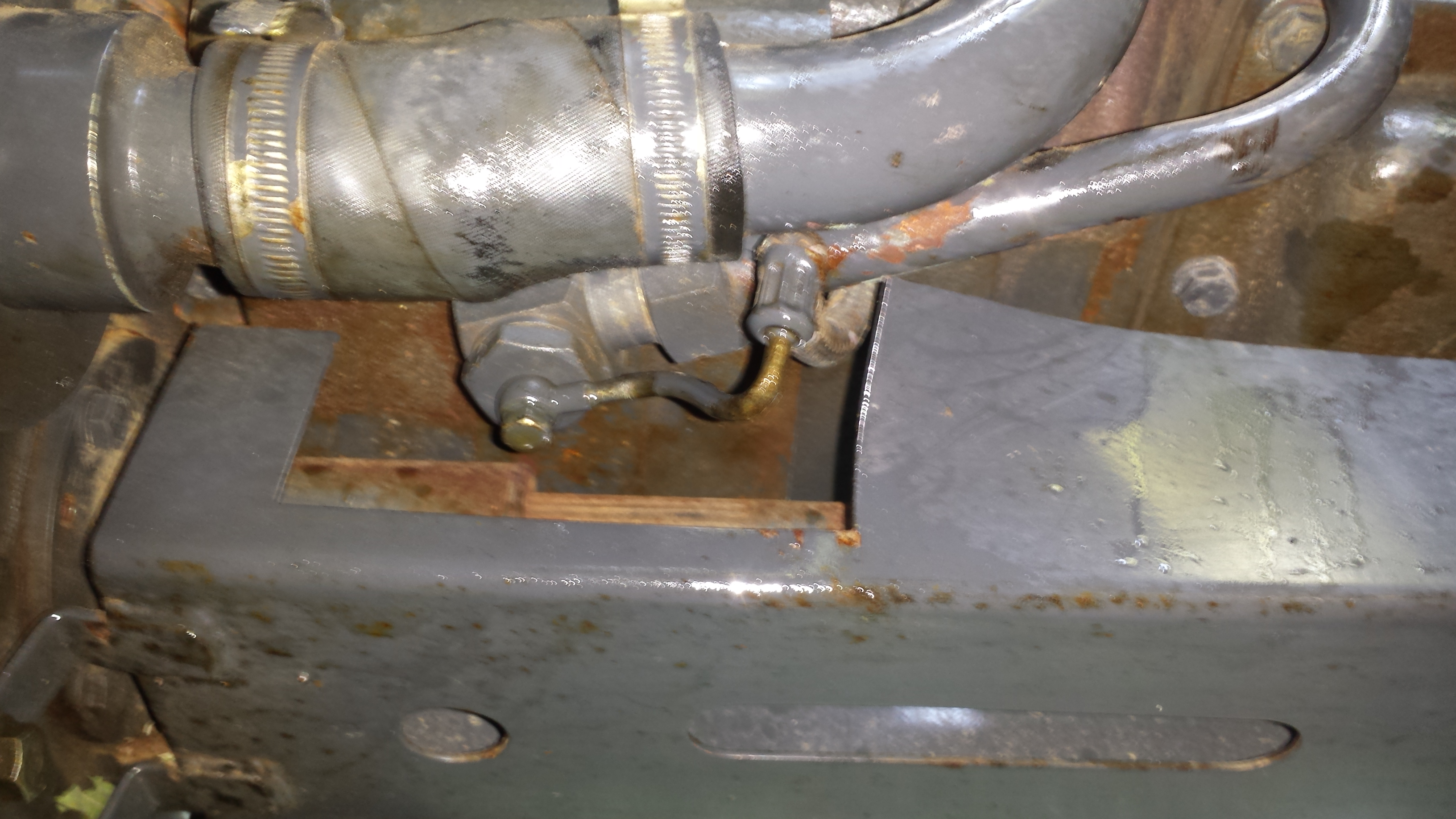

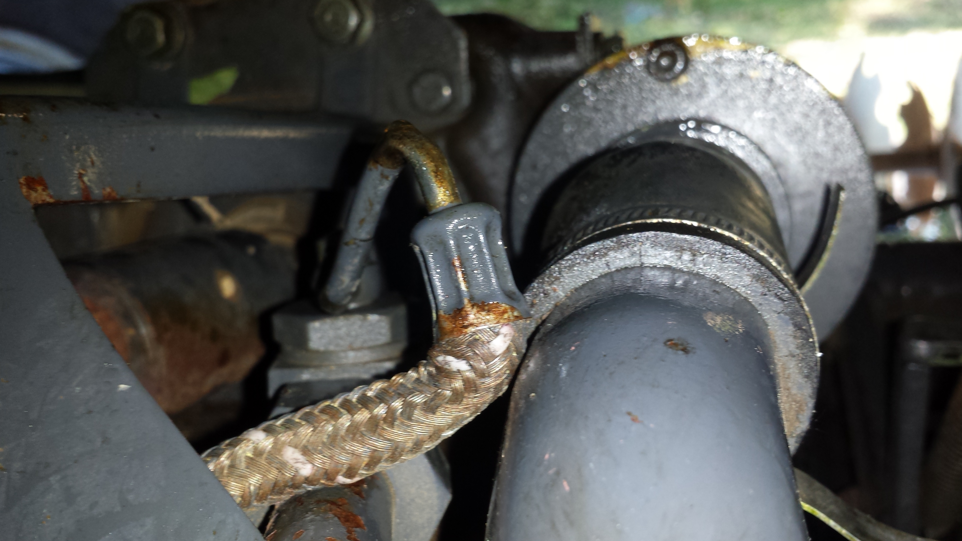

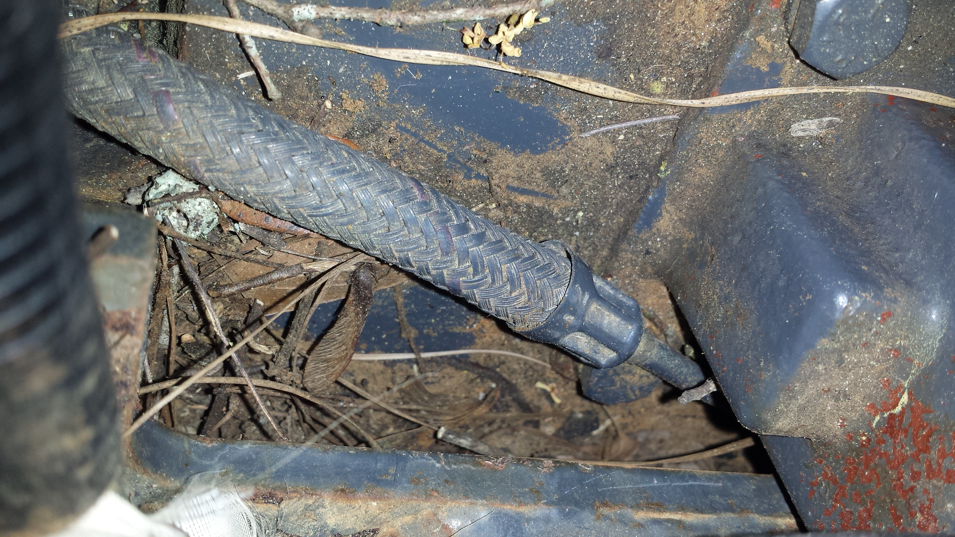

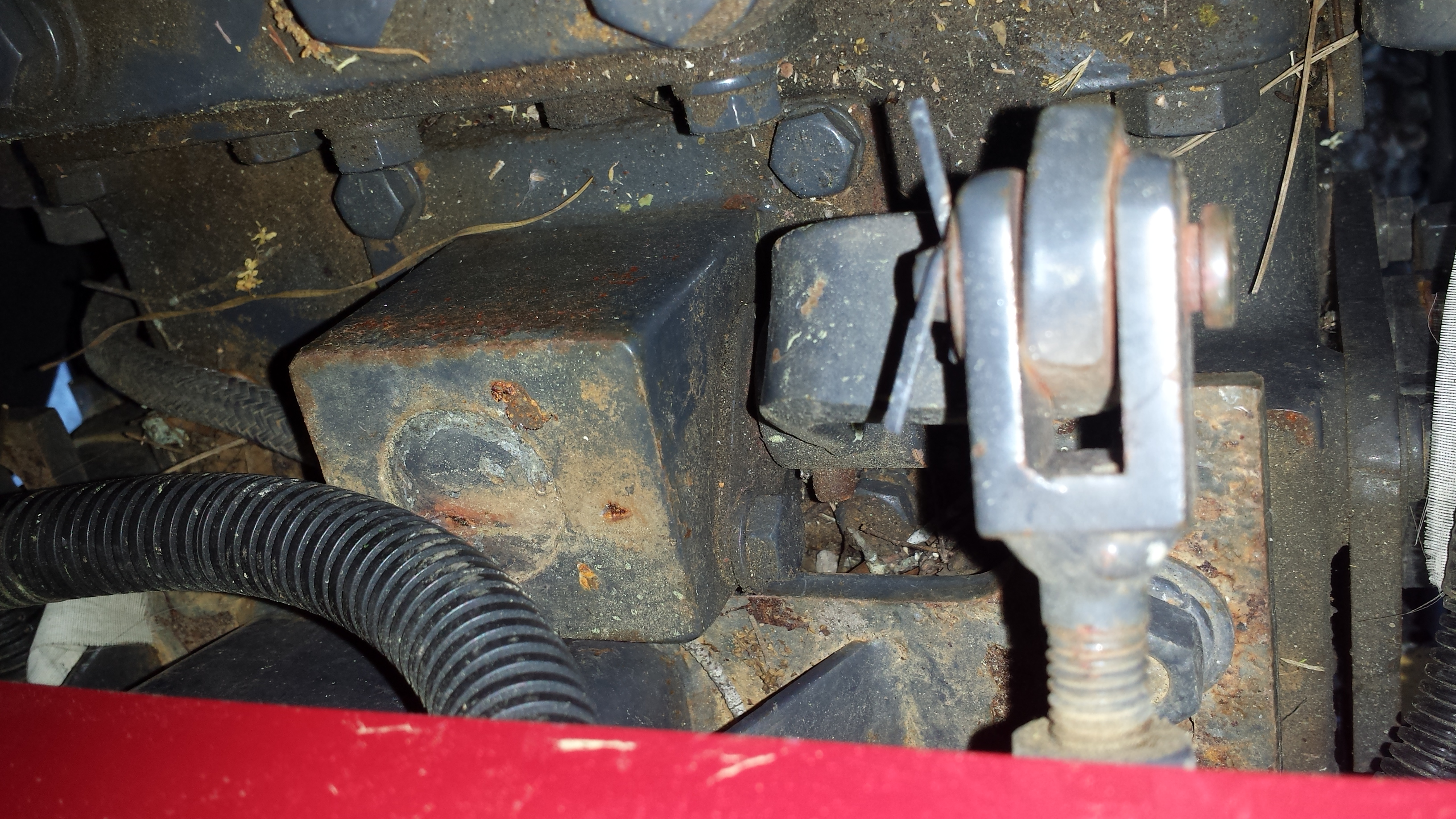

Mahindra 5530
Ive hit something and I think im dripping hydraulic fluid the first pics are under the tractor where the drips coming from. The other pics are on the operator platform under the red cover. This is a 5530 4x4. I dunno if its hydraulics or what. But to repair it i gotta take the square thing out cause its all attached to the hose. 1463363977250.jpg1463364003707.jpg

Sorry,I am no help,but I bent the same line on my 5530 (mine has not leaked yet).
Looks like fun getting to the upper part,so I just easily bent it back into place.
I'm interested as to what it goes to also.
Hope someone on here is able to get you the needed info.
the lower connection is under transfer case.
   / What part is this #3
near the right side of transfer case(if your sitting in the seat), not under it.
   / What part is this #4
Looks like the oiler for the synchronizer. That is the housing for the shuttle right?
Part number- E006509757C1
Id get 4 of these copper washers also 007202321C1

Yeah it ended up being the synchro forward/reverse body? Is what i can find. I just need to know if i have to replace the whole thing or is there a hose available i looked at parts list for about 3 hours today to find a diagram but no hose assembly shown on any of them think ill just take mt pictures to my dealer tomorrow see what he can come up with.
   / What part is this #6
The part number I gave you is the hose asmbly. Just type it into the shopping cart and it will bring it up. the only way to get around the original part that only comes as two banjos and the braided hose is to cut the crimps off and put rubber line back on with hose clamps.. id just order the part and washers to save time and trouble.
   / What part is this #8
006505648C1
That's the old part number is may be why your not able to see it...
In the catalog go under 5530 4wd its the same on t2-t3. Then look under ipto/slpto/transmission section, then choose pg 3 of forward and reverse housing assembly. Ref #51 is the part your needing which is 006505648C1... but its no longer available and should be highlighted green.. click on the green part number and it will bring up the alternative/new part numbers/number available. which is the E006509757C1.. that's if the public catalog even shows the old part #s. think its around $15
