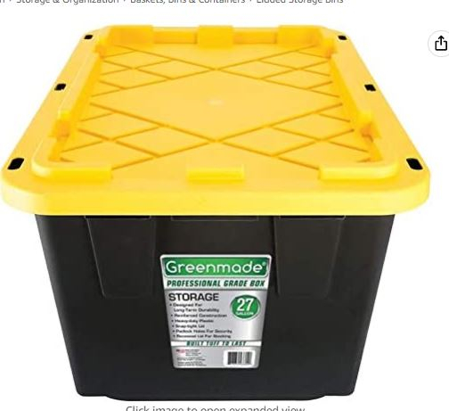

I must have 50 or 100 of these:
I've tried numerous labeling systems and all tend to fall off in the heat and humidity of Mississippi.
I had been using painters tape and a sharpie, but then had the labels fall off after 2 weeks.
So I'm wanting to paint a number on the black sides, spray paint white or orange with a stencil.
What's the best rattle can paint to stick to that type of plastic?

On light colored totes, I use a black chisel tip Sharpie.
On dark colored totes, I use a silver chisel tip Sharpie.
A lot of folks don’t know about the silver Sharpies. Many years ago a mechanic friend and coworker showed me. Invaluable for marking black metal parts.
Most Sharpies can be had in different sized tips to suite your needs.

First wipe the area with LACQUER THINNER. I myself use gas, but that's me. Also, can use gorilla tape as a background. The plastic outgasses and is why your other tape fell off. Gorilla tape comes in colors.
As far as paint, KRYLON FUSION is made for painting plastic yard furniture. Still use lacquer thinner to clean where you paint. I've been in the military and that's how it's done. Wall Marks has it. It's a rattle can spray paint. Painted my south Arkansas hood with it a few years ago.

Yes, that silver sharpie is nice for dark things. It stays too.
Thanks,
Krylon fusion for plastic linky must be new and is going for about $40/can, or 12 ounces. That's almost military pricing.
I went for the old style at Walmart ~ $7/can. linky
