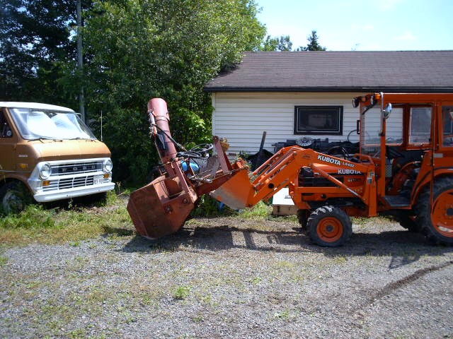

Here's how I did mine, based on research here on TBN and on previous experience with larger tractors. Frist, I reinforced the bucket edge with steel angle then I welded 2 grab hooks (one on each side of the bucket) and a slip hook in the centre of the bucket, all with J up so to lift over the front of the bucket. The 2 outside hooks allow 2-chain lifts (see photo), while the centre hook allows single chain lifts without tending to twist the loader or have dangerously offset loads. Why a slip hook in the centre....recommended by some TBNers, allows a little more flexibility (run the single chain through the slip hook and secure it in a grab hook on either side). Why the outer hooks at the bucket edge and not in line with the cylinders...just me, I guess...I figure the bucket has more strength there and it also allows more width for the 2-chain lifts.
Someone here on TBN added a hook to the centre of the back of the bucket for close-in lifts (more lift capacity). I like that idea and plan on doing that too.
Anyway, that's my take on it. Good luck!
