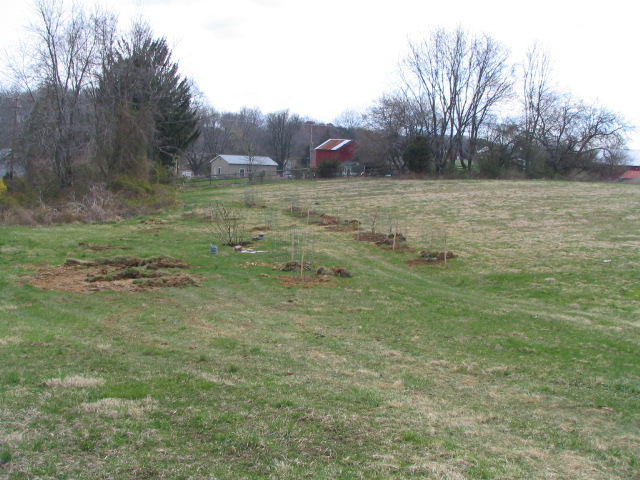

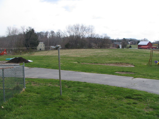

This is my back field. It is almost 2 acres and there is no brush, only grass and some weeds. It's a little bumpy but not to bad to travel over at slow-medium speed. I want to keep it cut fairly often so I was thinking finish mower. But, if it goes for a few weeks and the grass is a foot high or damp will a finish mower handle it? Finish mowers are also 50-100% more expensive than rotary cutters.:confused:

If the grass grows that fast plus being damp plus weather which could cause you getting behind in mowing I would lean towards rotary cutter....but if you like the looks of carpet cut that's a different story....more clumps of grass double mowing) and seat time.
/ What mower would you buy for this? #3
I cut about 7-1/2 acres of "grass" around my house. Most of it was hay field 2 years prior. It's not rough, but it's not finished lawn either. I cut it with a 6' Bush Hog (286) I keep the blades in decent shape. It doesn't give a golf course grade finish, but from the house, it looks mighty fine. I cut at approx. 3". For what you're looking at, a light duty mower would be MORE than enough. Just keep the blades touched up. (Maybe even slightly "sharper" than a bush hog blade would normally be sharpened)
/ What mower would you buy for this? #4
I agree with Farmwithjunk. I use a rotary cutter for all my mowing except the "manicured" lawn directly around my house. With reasonably sharp blades the cut is fine.
/ What mower would you buy for this? #5
You can get a pretty good cut with a rotary cutter. I had a cheapo Howse cutter before I got my used flail mower and with a good floating top link set up the rotary cutter did a great job.

My vote is also for a rotary cutter.. perhap s 4'

I second the rotary cutter recommendation.

I'll be the contrarian and say that I wouldn't use a rotary cutter on a regular basis there, for safety reasons - they throw stuff farther and faster than anything else. If you get one anyway, you absolutely must get safety chains, and disengage the pto whenever a person or pet gets close.
The best option, IMHO, would be a flail mower - less tendency to throw stuff and a finer cut, but still able to tackle tall grass and brush. I don't know prices but I think they are $$$. I would be inclined to get a finish mower if the flail was too expensive. A sickle bar mower might be an option too, though they can also be expensive.
/ What mower would you buy for this? #11
i think you should buy a good used finish mower and a good used rotary cutter, and see what works best. sell the one you don't want. only problem is you'll probably want to keep both.
/ What mower would you buy for this? #12
Good advice here but don't discount that a good finish mower won't cut that area. I used a 5' LandPride for 14 years over rougher ground than that. Approximately 5 acres per week at 34 weeks per year. If I had to choose only one unit then yes I would get the rotary cutter.
/ What mower would you buy for this? #13
I like flail mowers... sort of a cross between finish and rough cut. Only drawback is price.
