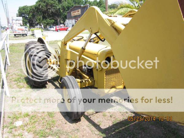

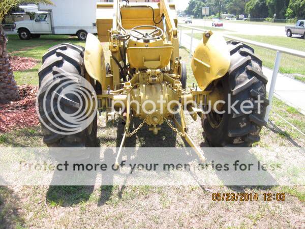

Came across a Craig's list post that's interesting me. But the current owner doesn't know what model it is. In the listing it says 50hp, he said its about a 65hp. One thing he knows for sure is that's its a perkins diesel 4 cylinder.
Here are a few pics.
   / What model? #2
Massey Ferguson for sure not sure of model. Maybe a 35 or 135. Check tractordata.com for Massey's about that size.
   / What model? #3
I'm guessing that it's an industrial model. Maybe a 30 or 50. Do a web search for those.
   / What model?
It's defiantly not a 35 or 135
I actually surfed around tractor data looking for models that might be similar to it. Haven't been to successful.
He's claiming its 65hp, the 30 is only 30hp.
The 50 is only a 3 cylinder diesel.
   / What model? #5
   / What model?
No sir, the 50 Industrial is a 4 cylinder Perkins. TractorData.com Massey Ferguson 50 industrial tractor information
That is the TractorData page for the 50. You can click on "Next Model" and go all the way through the 50C. All 4 cyl.
And the 50 was a 62HP engine, the A was a 68.
BTW, I had a early '80's 50C.
Ahh didn't look at the industrial one. Only saw the reg 50. No pics to compare it on their site though. Will try searching for other industrial 50's.
   / What model?
Looked at those, but they came in 3 cylinders.
   / What model?
Decided to go and pick it up today. Seams the guy didn't know to much about it. It turned out to have a 3 cylinder perkins. Besides the 3 pt hitch not working too great, the rest of it seams ok. I am gonna have to get some shifter boots as the ones on it are gone, and I noticed the trany oil was already turning a little milky. Another thing on the list are new bushings and pins for the bucket. I'd like to get a 3 spool and move it over to the right side.... But not sure how I'm going to do that yet, as the right side of the front end loader frame doesn't have provisions to swap it over.
The tag is pretty faded. The serial stamping is stil there. It's A 831600, I tried to do a search on tractor data.com but ended up getting a error page. Any one have any ideas?
