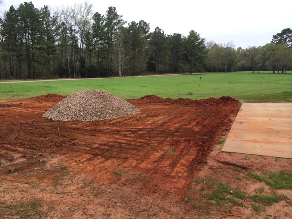

Howdy fellow TBNers,
Just about finished with our new build. We had a 30x20' concrete apron poured at the approach for our two-car garage for now. I wanted to wait to pour more concrete until we move out there and get a feel for our entering / backing out of the garage habits.
So right now, it's just very clay-like red East Texas dirt at the approach of the apron. I'm wanting to put down about 20' of some kind of gravel or driveway grade material to go over all the dirt and provide a nice transition onto the driveway - but also material that could be scraped up and dumped on my long driveway if we decided to do more concrete in the coming months.
What's the best stuff for this kind of job? I had thought about caliche (which is what I have on my long driveway), but figured that would not be as nice to scrape up and move in the future. It can also be a little mucky when it rains real hard.
Do I just go with some type of medium sized wash rock?
Let me know what has worked for y'all.
Much appreciated!

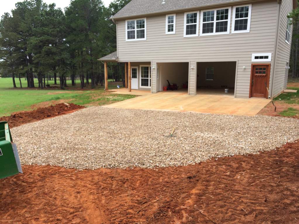

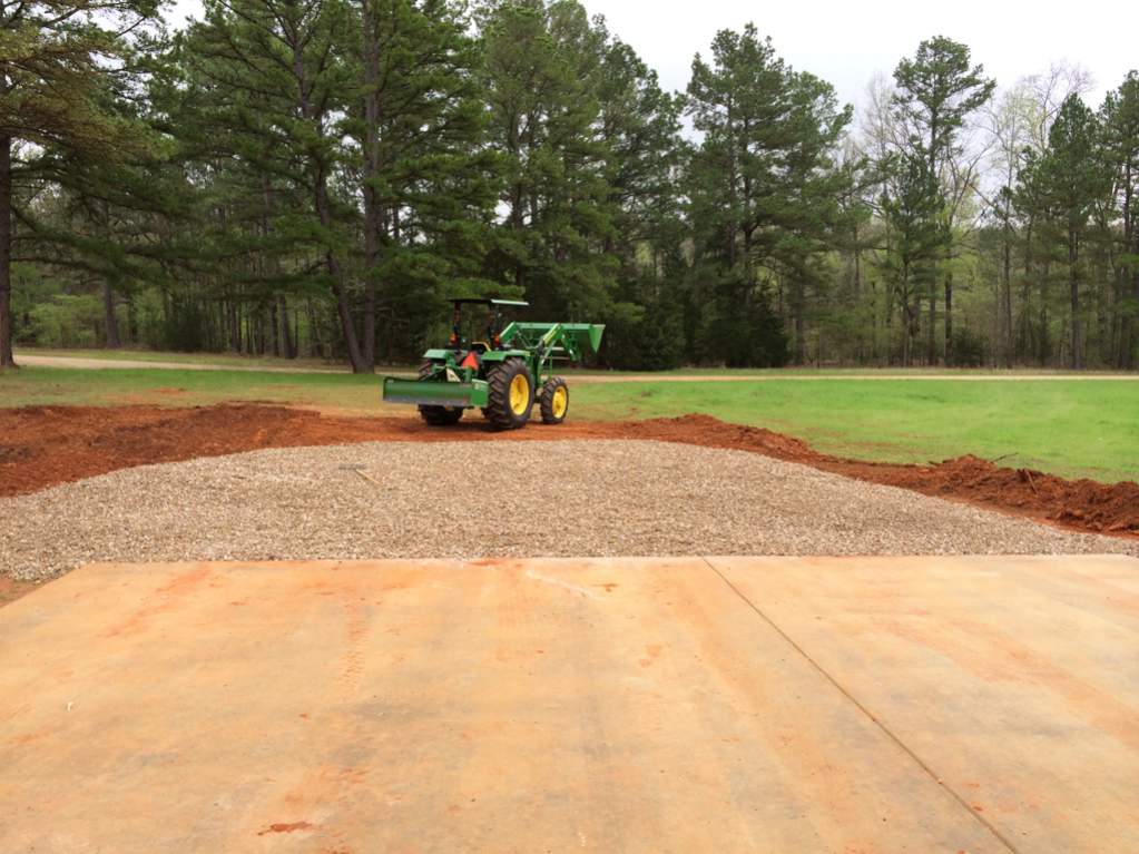

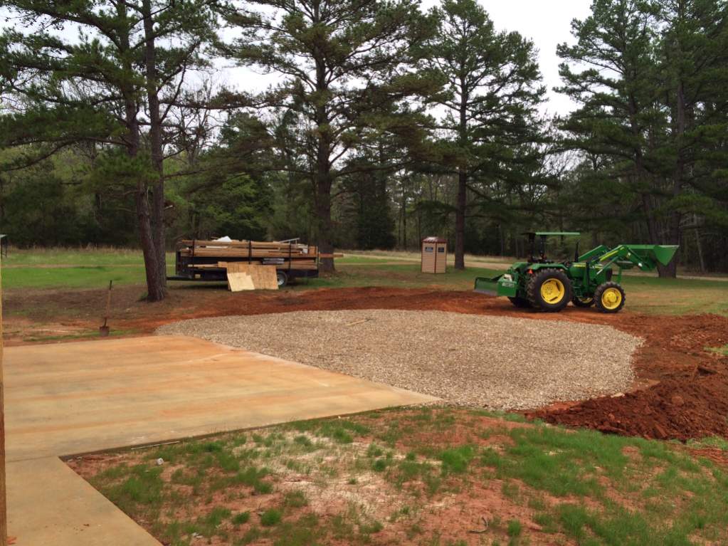

Thanks for the replies, everyone!
Got R done this AM, before the rain hits again tomorrow / Thurs.
I'll leave it like this for a while and let the 1" rocks get good and packed into the clay base, then probably put some finer stuff down on top in a couple months.
image-2454235033.jpg image-4110258960.jpg image-1724746501.jpg image-2394002565.jpg
Where the trailer is parked is where the rest of the driveway will be put in a couple weeks down the road... which is why I spread the gravel out the way I did - wanting to keep it out of the pasture as much as possible.
