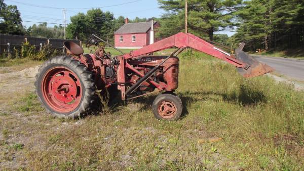

I Just added a Farmall Super "C" (narrow front) to my farms equipment and it came with a front loader with the old style trip bucket loader with Hydraulic rams etc. What i'm trying to figure out is the specs on the lift rams. I Need wiper seals/packing ? to stop slow leaks in both tubes. What companies sold these to begin with? It is the steel plate welded type, not the welded tube/pipe frame type. would it be cheaper to just pull off the rams and take them and get them rebuilt? Thanks, Tom

I had the same problem with my Ferguson with a Wagner lift. I found someone local who was able to rebuild the rams. Can't remember who it was.

The shafts were left extended too long and got rust pitted and a bad score on one. but i filed the high spots smooth and emery clothed them down good and tightened the cap end bolts and the leaking slowed down a good bit, but i think it may need new wiper seals to give it a fighting chance.

Farmhand

Mine weren't rusted, just worn out.
