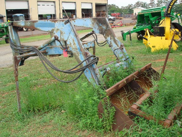

I have been looking at a used NEW HOLLAND 270TL Front End Loader for my 1993 Ford 3930 Tractor. Can anyone tell me if that will fit a Ford 3930

First thing I see is that you need an adapter bracket for the tractor to accept the loader. The bracket will bolt to your frame in some fashion to support the loader. Without that the thing in the picture is useless to you. I bought one years ago from Koyker Mfg. (Koyker Manufacturing) for my JD. It was delivered to the house and was very reasonably priced containing everything needed to install. Plus it was made for that tractor, not some kind of gee I hope this will work. With you not having an adaptor, I think your best bet would be to look elsewhere. As I recall I did have to go to TSC and get a dual spool control and hoses for it. Then you would have to see on your tractor where to mount the control and possibly fabricate a mounting bracket. I don't see a set of controls with the one in your picture either.

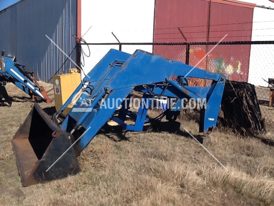

The Ford 7209 is the loader that fits the Ford 3930 Tractor 2WD. I have attached a picture here.Ford 7209 Front End loader.jpg
It is hard to find one of these these days. Of course you can buy a new Woods, Rhino, Westerndorf
   / What Loader will fit a 1993 Ford 3930 45 HP Diesel Tractor #4
The Ford 7209 is the loader that fits the Ford 3930 Tractor 2WD. I have attached a picture here.View attachment 395536
And it has the bracket you need. Is that one for sale?

7310 possible as well with right mount.
Don't you mean the 7210 (a picture is attached here). Either way the 7209 and 7210 are difficult to find these days.
   / What Loader will fit a 1993 Ford 3930 45 HP Diesel Tractor #8
I found this online of a 3910 with a 270tl loader.
It can certainly be done, I have seen quite a few of the CASE IH L360 being adapted to older farm tractors. Depending on the price it may be worth trying it.
