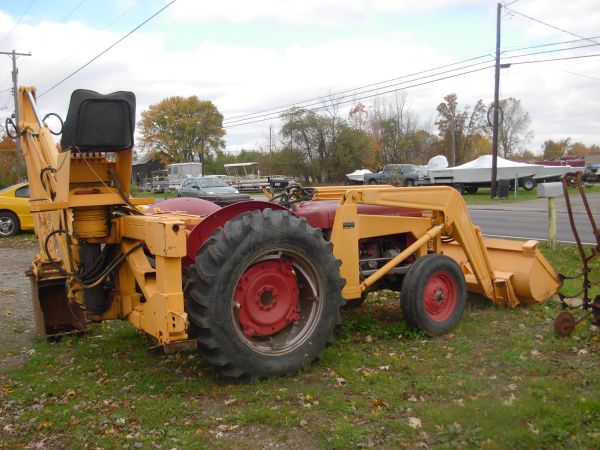

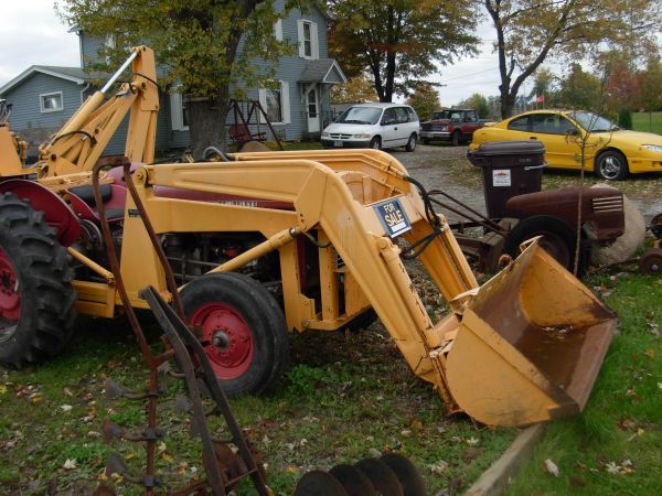

I wish I could be more help to you but what I can do is post of few pics of mine and maybe someone here can tell you what kind it is. I bought this 1959 TO 35 this way and have used it and had no problems other the the steering leaking onto the trans.backhoe1.jpgbackhoe3.jpg
   / What loader models with fit a Massey TO-35? #9
Bonez, Is that a serial no. tag on the right hand side of the loader frame or is it a dealer tag?
   / What loader models with fit a Massey TO-35? #10
I will look tomorrow but I think it's a dealer tag.What ever I find I will post tomorrow night.
