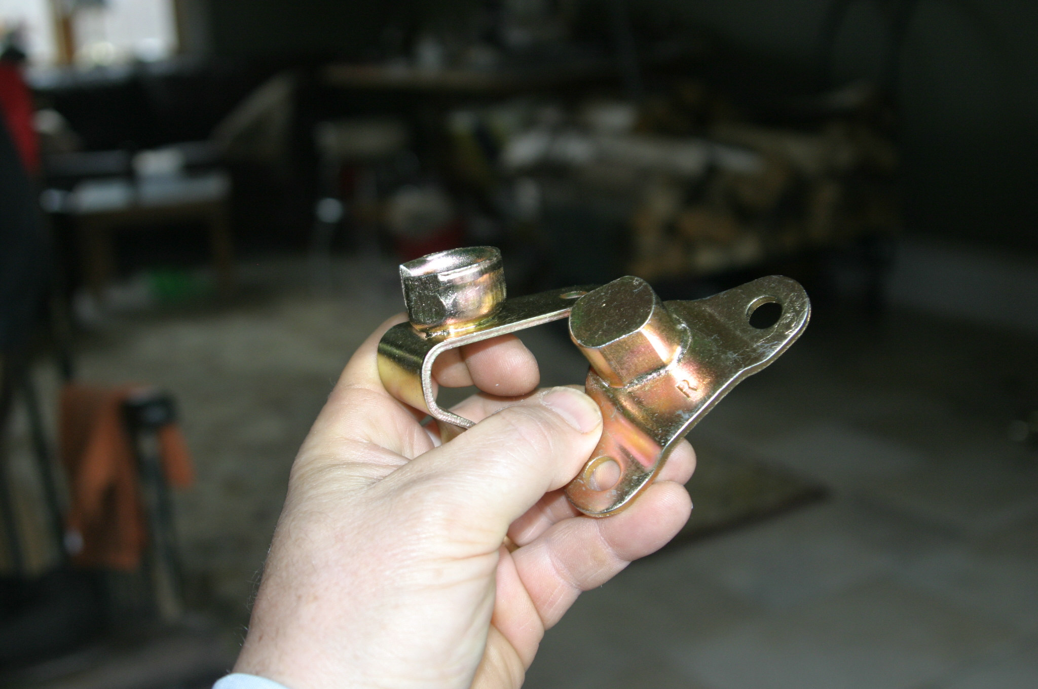

Can hardly see a bead. Tail gate hinges.

Almost looks like TIG with no filler rod. I had hinges on my hot tub cover

I don't know, but I think that is some sort of machine spot weld where the pieces are brought together charged to different polarity's. Just guessing, but that is what I think.

I don't think you'd see a fillet weld with a spot weld, James...
Although it looks like a nice TIG weld, that's not too common for production welding.
So, I'm thinking it's MIG done robotically.

possibly electrical fusion ?

Fusion weld with tig, no filler. Robs660 was the winner!!!!!!!!!

Could be forge welded. Maybe even solider just because of the differnt colors. But I have seen tig welds that small and even smaller too. When i was in high school my teacher had a small metal fuel filter with a tig weld so small on the screen that you had to have a magnifying glass just to see that it was welded.

Working in a food plant we have to be pretty strict about welds on our equipment. I've seen tig welds so good that one could hardly tell a weld was there. This weld looks like a tig weld.
