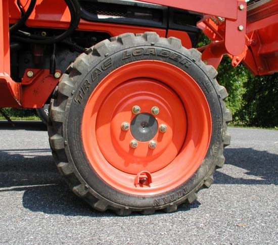

Here's a pic of a front tire on my B7500. It has a 302 loader that is filled with damp topsoil in the photo. Inflation is about 12#. The R4's put a lot more rubber on the ground and are stiffer than R1's................chim
