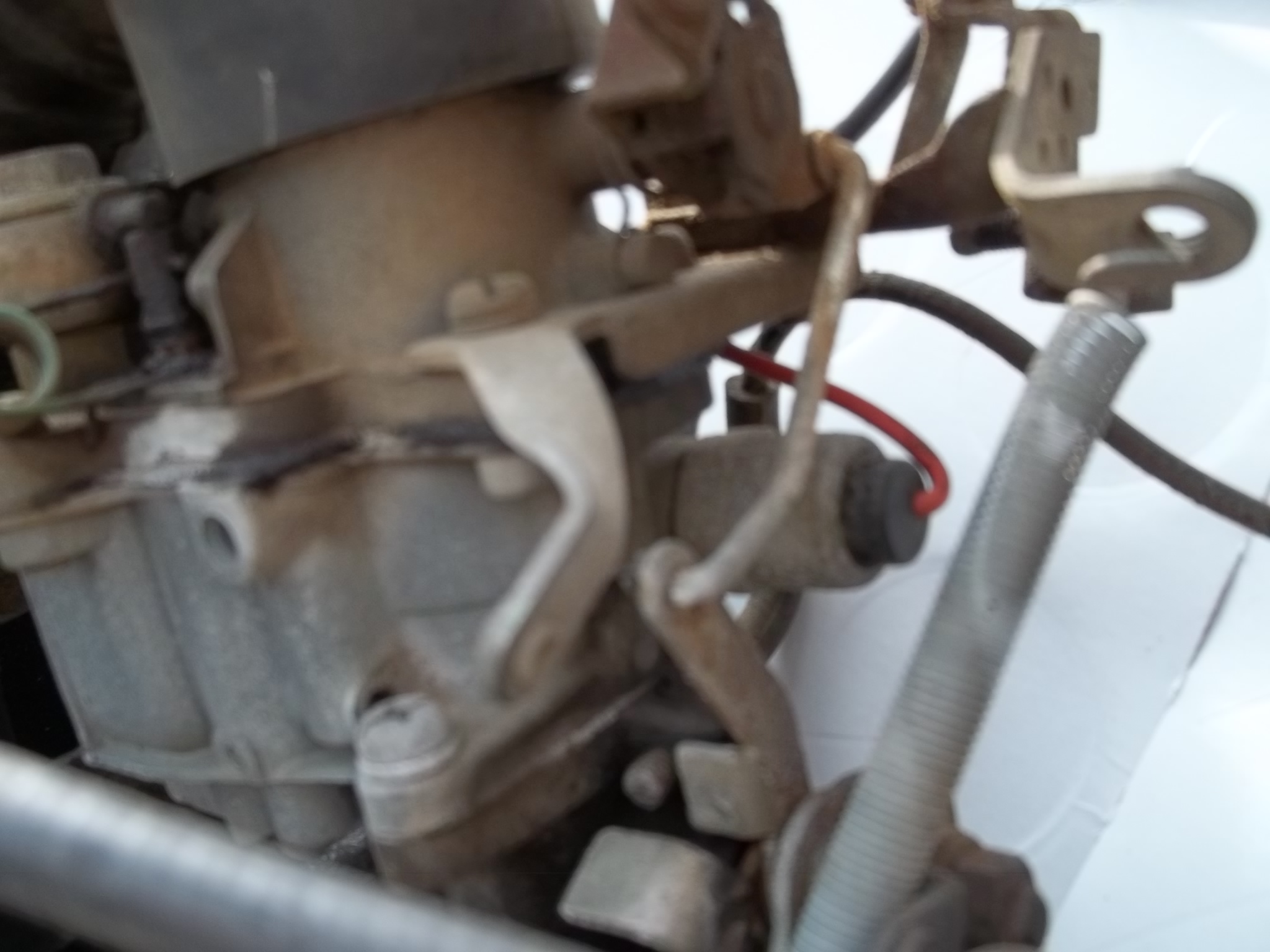

Wes, This is a 12volt wire. Any ideas? Try to send pix.
   / What is wire to carb. for? #8
That is a Idle fuel solinoid. It need 12 volts to it to open the Idle fuel passage.
That carb though appears to be not a original for the s650g Mazda engine.
Lee
   / What is wire to carb. for? #9
I agree with Lee. There were only 2 carbs. on original equipment and this doesn't look like either. Maybe the folks at Valley Power can help you get the right carb.
Valley Power
1-800-609-5110
Wes
