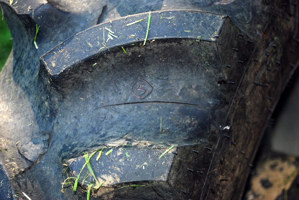

One other question -- Any one having problems with the R1 Titans on the front end? I have one that is developing what looks like knife cuts in it. I checked one time and had about 3 cuts, by the end of the day I had 6 cuts. Noo rocks or sharp objects, I think the tire is splitting on its own.

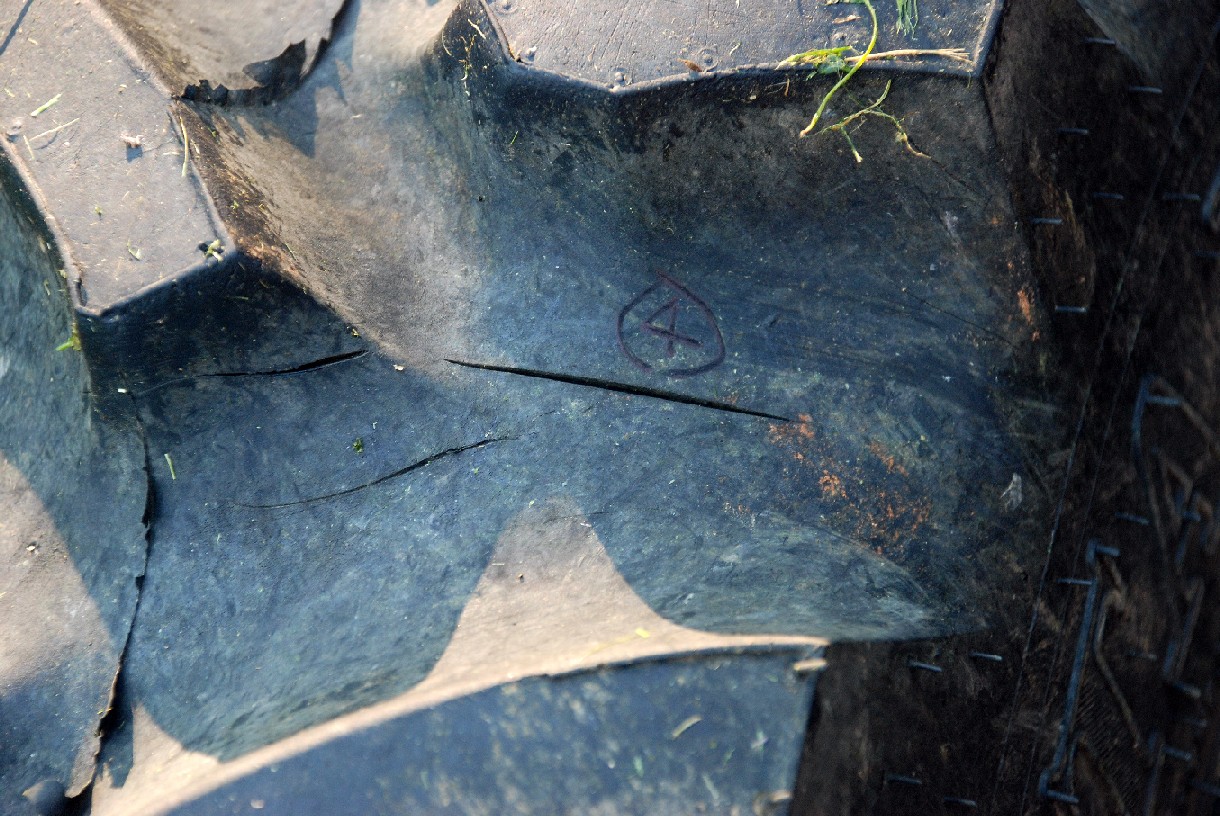

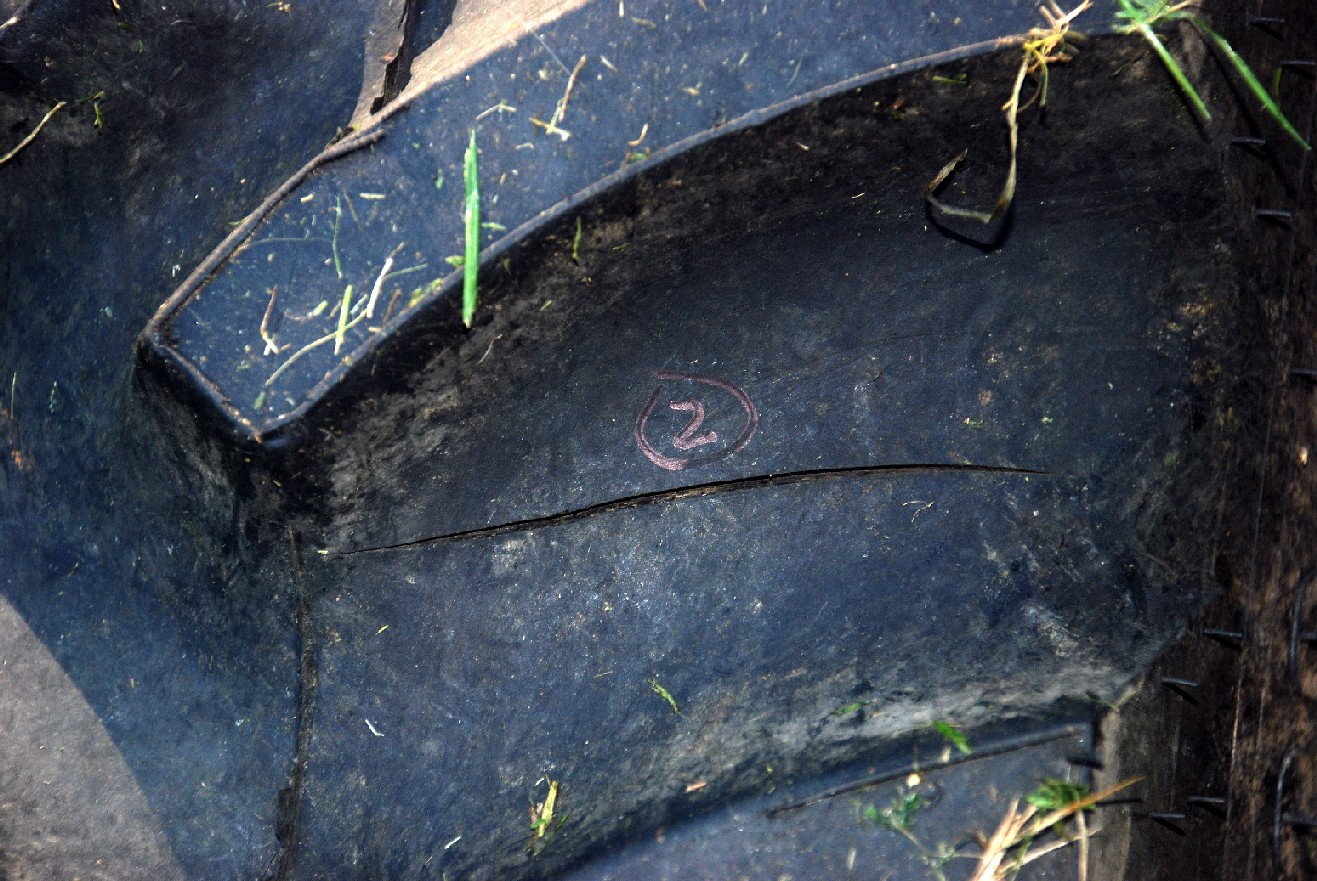

Just figured out how to resize pictures. Here are the cuts developing in the tires

If this is a new tractor contact your dealer about getting those tires replaced under warranty.

Red the other tire is not showing cracks like these yet. Do you think I should insist that they replace both of the tires? And yes this is a new tractor I just turned 20 hours this weekend.

I do believe youre on to something. My Titans have lots of those, spread around on all 4. Some of them them are obvious cuts, shallow and circumferentially directed. Some are crossways like yours tho. Some are at the strain edge of a lug. A few are deeper. I have 260hrs. I have heard problems with regard to tires that went into service too soon after demolding. They need more time to fully cure. Perhaps this is what you are seeing the results of - and me to a lesser extent I believe.

I would just get them to replace the tire showing damage. I've seen this on multiple new units we've received during our inspections.
