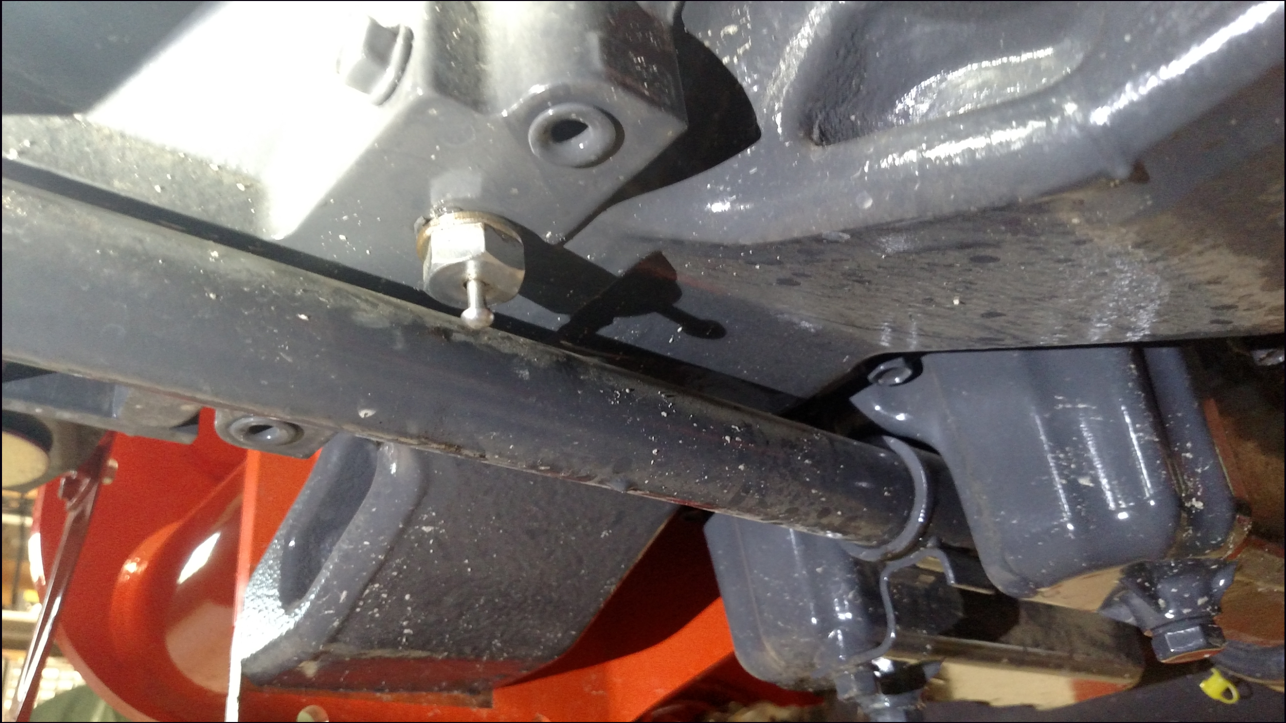

I was crawling around under my L2501 today and found a few more zerk fittings. While greasing I came across this big nut with (not sure what to call it) a movable pin. Looks like some kind of vent maybe, but I'm not sure. Any ideas. Thanks
   / What is this? #3
Sounds like he is describing the clutch housing water drain.

   / What is this? #6
Definitely the clutch housing drain. Push the pin up, if water spits out, remove the nut to drain the housing.
   / What is this?
Thanks, I did push it up, nothing came out.
   / What is this? #8
It's basically an "upside down" breather - drain. RJ nailed it.
   / What is this? #9
Of course you did!! :laughing:
I think we've all been there: "Hmm, I wonder what this button does? I don't know. I'm just going to push it and see what happens."
   / What is this? #10
LOL... how true.
I guess my use doesn't lend to getting water in the housing, as 15+ years of button pushing never resulted in water coming out.
