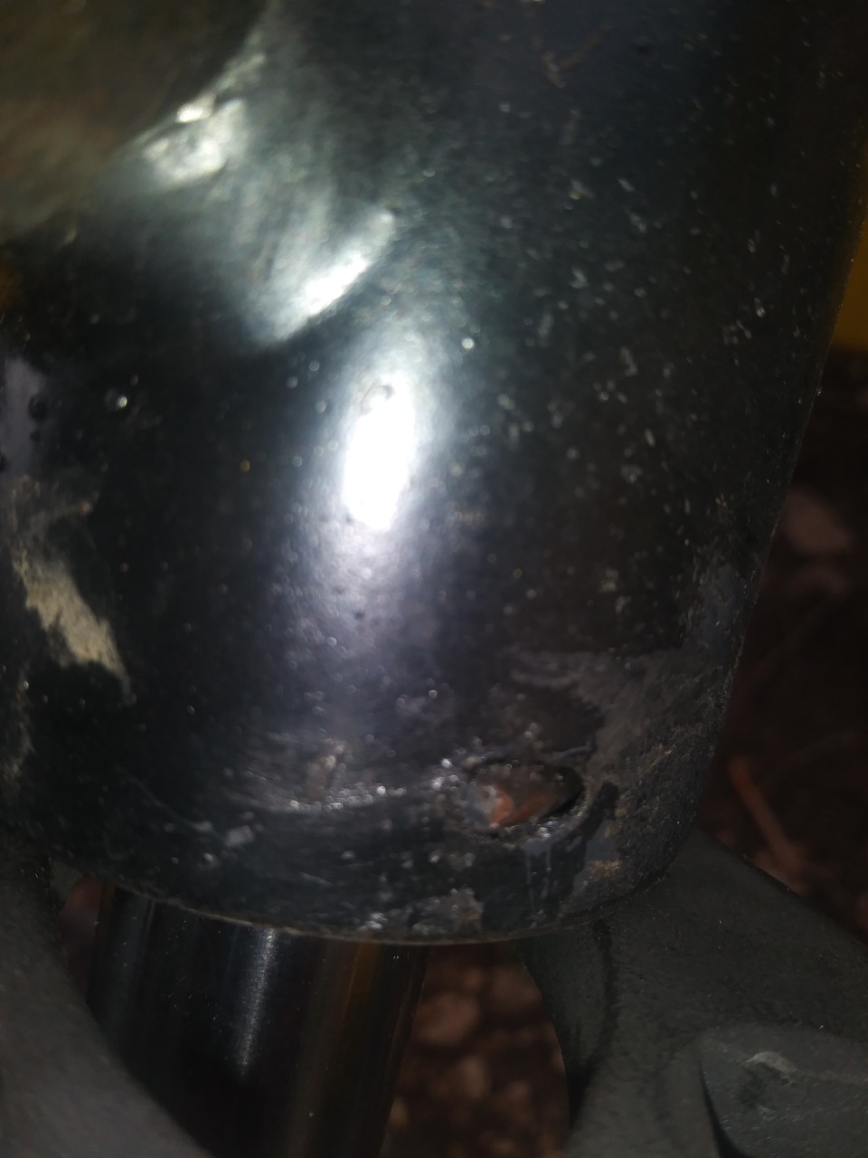

WHAT IS THIS ??? Trying to unscrew end of hydraulic cylinder .

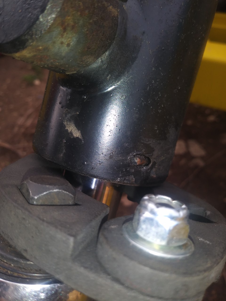

So there is a piece of metal that sticks out of hole when I try to unscrew cap and stops it. I dont want to break anything so anyone seen this style ? This on a T5c backhoe hydraulic cylinder, hyd2.jpg

I found out what it was.
   / WHAT IS THIS ??? Trying to unscrew end of hydraulic cylinder . #5
cylinder lock wire
Its called a square wire. It locks it in place
