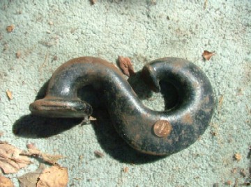

Don't know where else to ask this! What is this thing I found at a yard sale? Heavy piece of probably forged steel as shown. Penny laid on top of it for scale.

Probably has a "real name", but I've always called 'em "choker hooks". Made to use on the end of a steel cable (with eye) Used in rigging (cranes) and sometimes found around loggers.
End with bigger mushroomed hook goes through cable eye. Other end serves as hook for other slings, cables, chains, ect....

Yup, Farmer has it nailed! We use them on our polecats at work(Verizon). A polecat is like a crane that is used to set utility poles, it has claws at the top to help steady the pole.
