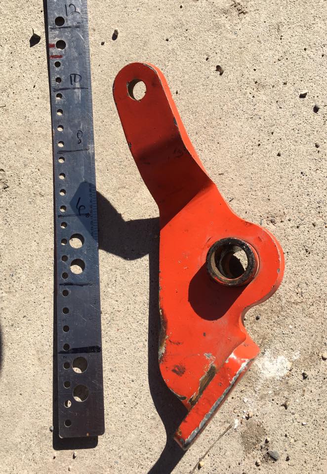

3-Point Hitch what is this part
   / what is this part #1
DianneInVA
Jul 5, 2013
146
Fosston, MN
Kubota L3301
I removed the backhoe from my B2620 and am trying to reinstall the 3 point arms so I can attach the cultivator. I have a part left over! ( not really: it goes on the left lift arm...somehow) I don't see it in the manual and can't remember what it does, or how to install it.
   / what is this part #3
And there should be another Bracket one on the other side also, adjustable rod linkage fits in the smaller hole that goes to another bracket above the MMM.
