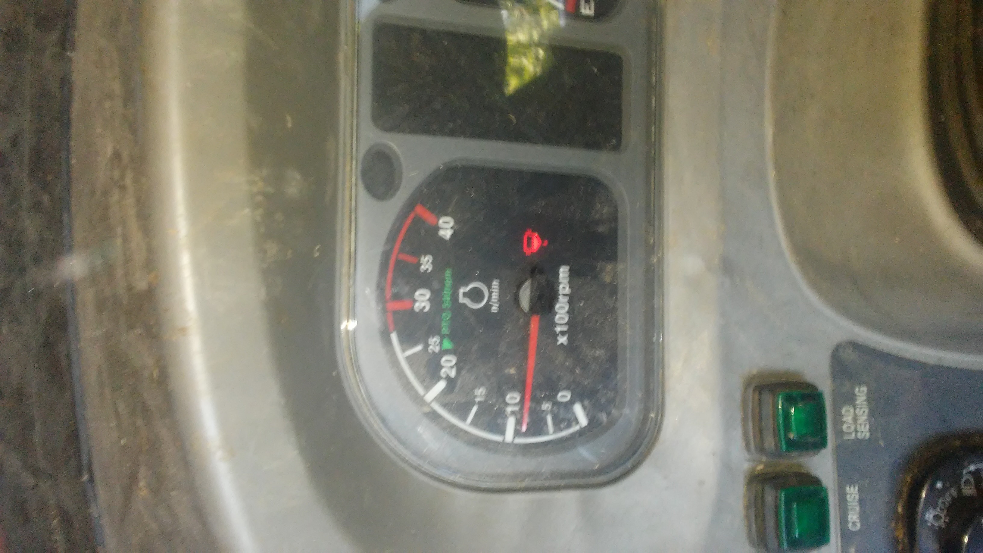

Looks like an acorn.

I have not found it in either the Mahindra or TYM manual..... but, I would bet that it is water in the fuel filter... Just from the picture. You should never have that come on unless you are not practicing safe sex, I mean putting only fresh clean fuel in your tractor. I have been driving diesels for over 20 years and never have had a water problem.... But I am allergic to penicillin from too many trips to Manila and Saigon... [[ :) ]]

Yup, that is a ' universal symbol ' for water in fuel. It shows a filter with a water drop underneath it.....

Back off the water drain from the filter until it lets it out.. do that for a bit until you smell good fresh fuel. Also would unplug the sensor at the but connection to the harness and be sure theres no build up inside

I'll check it tomorrow. The manual is sparse on information.
