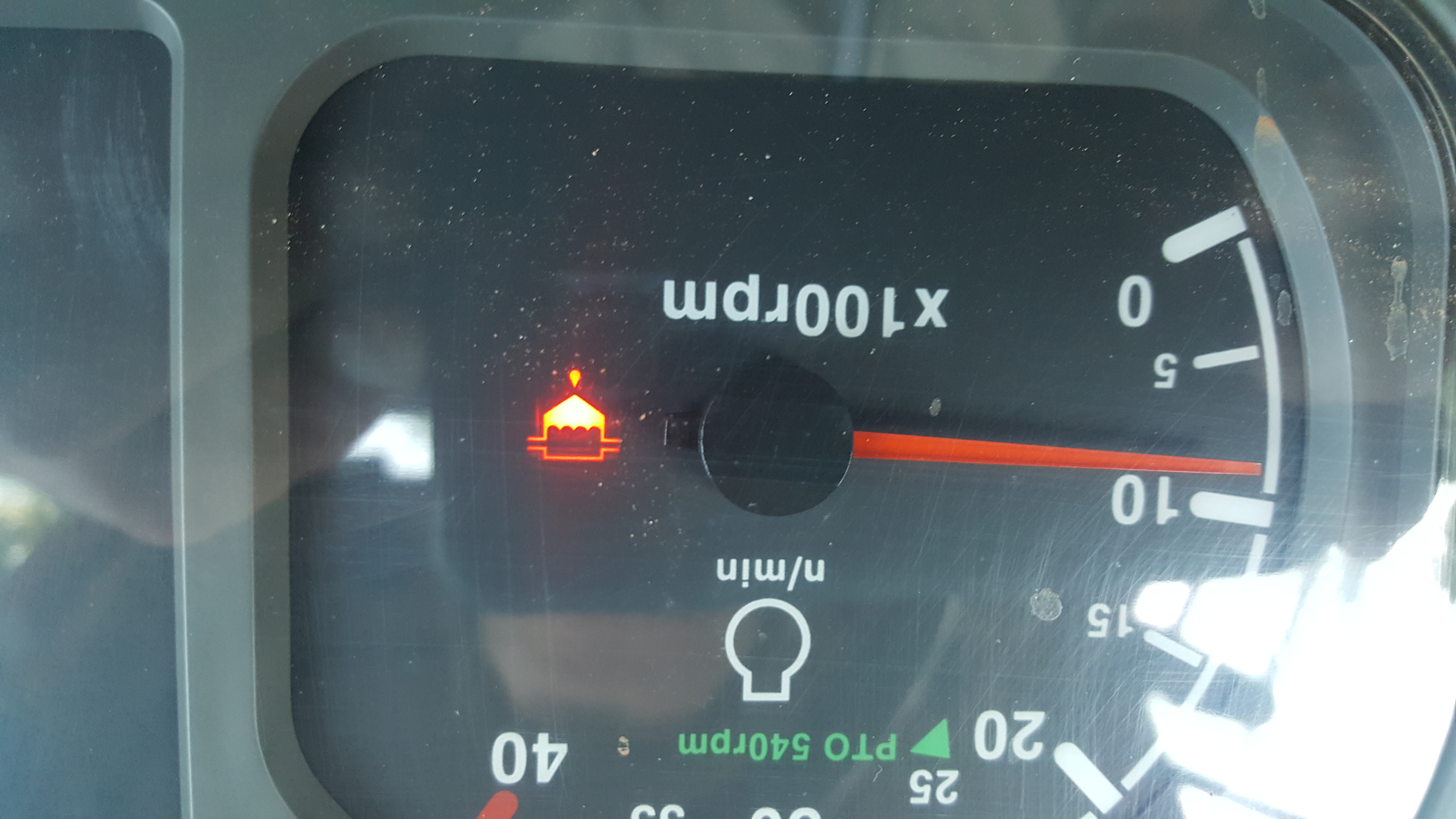

Can some of you fellow Mahindra owners or dealers tell me what this light is for? I have not seen it as best I can remember. I went out to do some cleaning this evening after getting home from work, & after about 5 minutes I noticed it was on. I have thoroughly looked through the manual & can find a picture of it, but no explanation! I have checked all the fluids, it's not running hot or anything, sounds like it alway has. Any help would be greatly appreciated!

I believe it's the water in fuel filter light.
   / What is this light for? #4
I agree with Bilko. Water in fuel sensor.

Water in the fuel.
If you have a paper element 1st fuel filter like I do, it's likely trash and needs to be replaced. On my machine the moisture sensor is placed at the 2nd filter where it's already too late if the warning comes on.

It means that it is time to milk your tractor...... As above, a picture of a filter with a drop under it is ' supposed to be ' the universal symbol for having something in the bottom of your fuel filter besides fuel... something that conducts electricity better than fuel... like water. If you are getting water, you have to ask yourself why. Water in fuel happens, but usually from bad fuel, buying fuel from a source that does not have much turnover of stock, bad fueling practices, or what ever. You should strive to never have anything in your tank except clean fresh fuel, especially in the winter. [ kind of dizzy from standing up on this podium, Sorry... ] :)

Thanks for the info guys! I don't know why the picture posted upside down, but I assure you that I was not standing on my head, the old body would never tolerate that!
   / What is this light for? #10
Don't know why but this board software seems to do that kinda thing with the thumbnails a lot but when you click the thumbnail link the full size image always seems to come out right.
