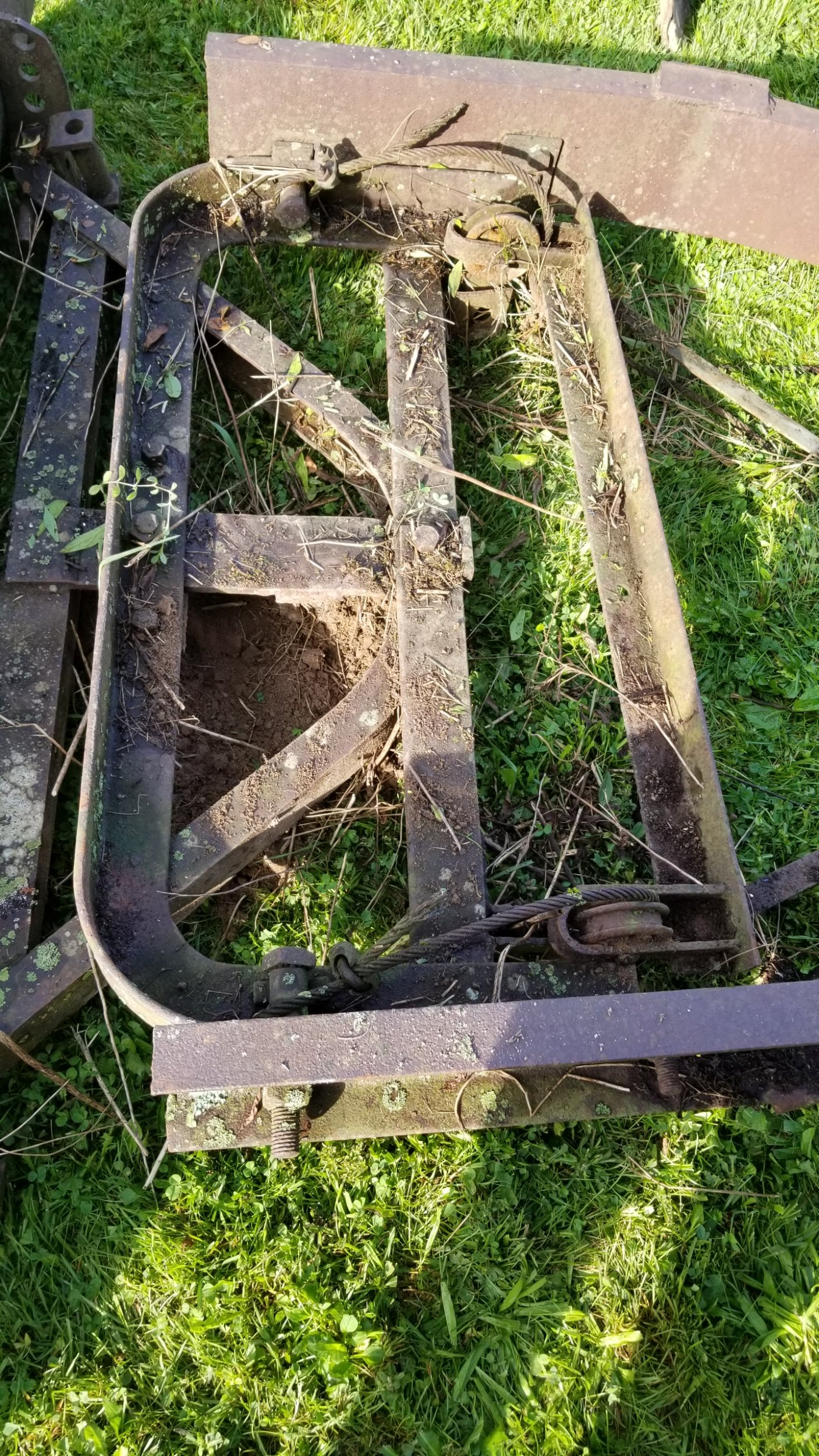

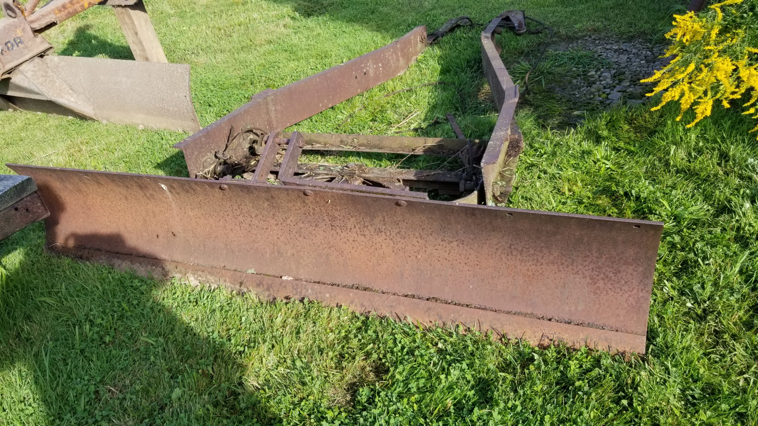

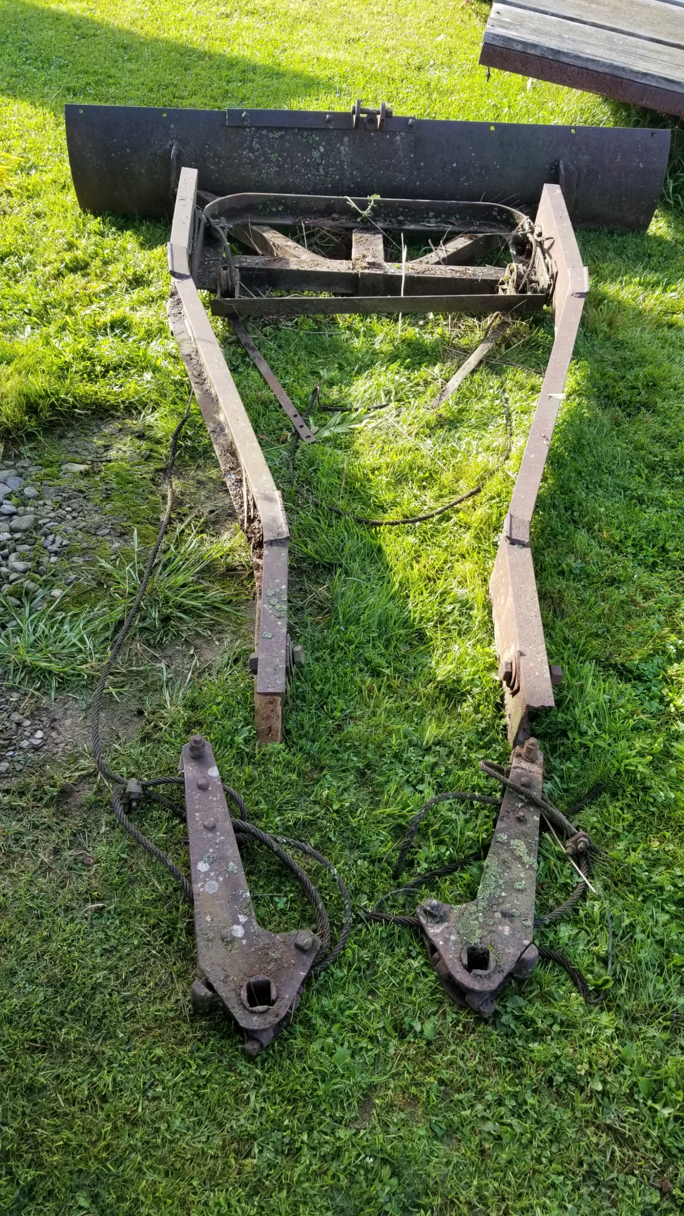

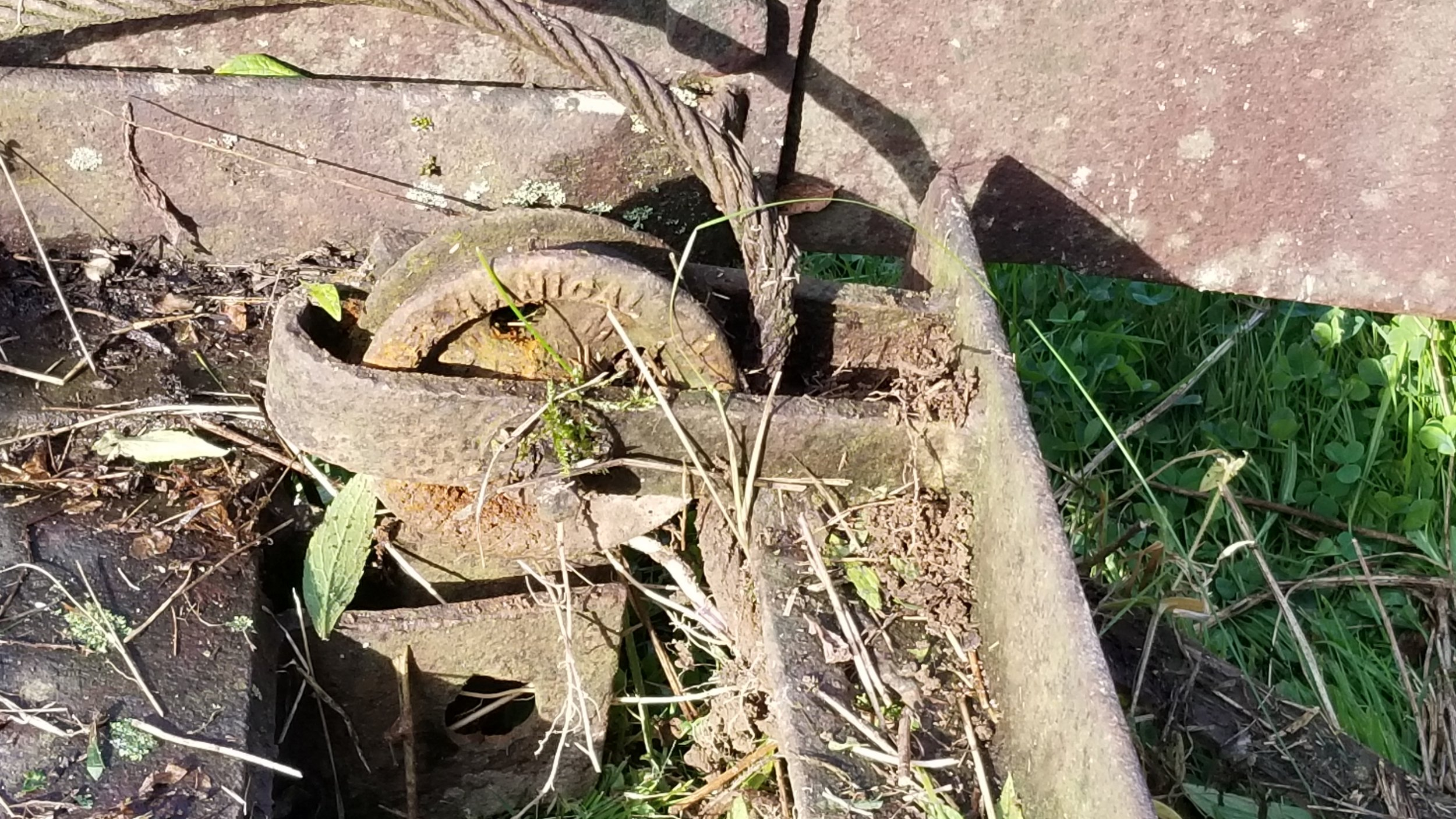

Other than old.... Has been sitting out back of the barn on our property for as long as I can remember. Blade is 7' wide. Inside of back part is 17". It's just under 8' long end to end. Seems like maybe it went on tractor somehow and had cables to lift via rear 3 point hitch? One pulley looks like it has "mechanical stamped on it. Want to sell it but don't even know what it is.

I suspect it was an 'underslung' pusher blade.
Clamps would have been mounted onto rear axle so as to have all forces transmitted to rear axle housing.
Raising would have been via a cable/chain attached to the FEL. (possibly a winch also)
Kind of like a poor mans dozer.
I've seen that type of setup a few times.

oh wait "Front End Loader"? maybe? It's interesting because it does have a spot in the center top of the blade to attach a cable or something. Wonder what those brackets and lines are running off it then or if that somehow attached up front.
   / What is this 7' plow blade?
Found this on youtube and now it makes sense!
So the pulley thing attaches up front and then those "L" things are for the rockshaft.
