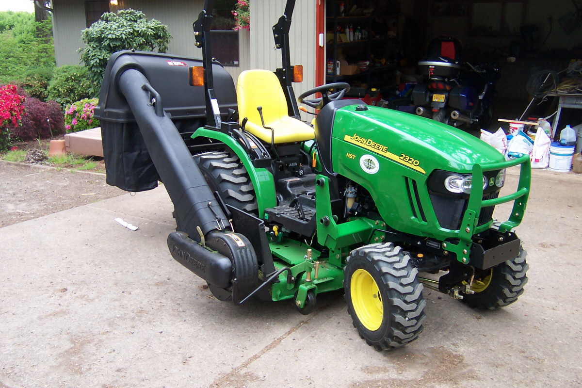

Looking at a new 2320, and there is one option that I am not familiar with. What is the powerflow option, and what would I need it for?
Joe
   / What is the powerflow option? #2
I believe powerflow is what they call the grass collection system that attached to the 54D/62D mower decks. It has a blower motor in it (driven off either the mid or rear PTO) that helps put the grass back in the bagger.
   / What is the powerflow option? #3
Hey Joe, the powerflow is the bagger system for the 2320. There is an plastic impeller unit that connects the deck with one of the blade pulleys. There is a pulley belt that routed around the pulley and when the mower blades is spinning, so is the impeller for the grass catcher. It sends it up through plastic shoot and into the bags in the back of the machine, Its a nice setup. I have one on my 585 GT. I can imagine the setup is very expensive. If I remember correctly, my unit was $1200.00. Russ
   / What is the powerflow option? #4
Power Flow, see below...
