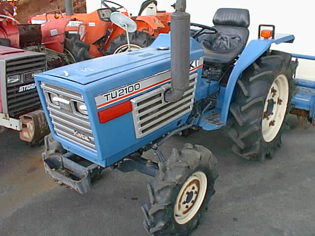

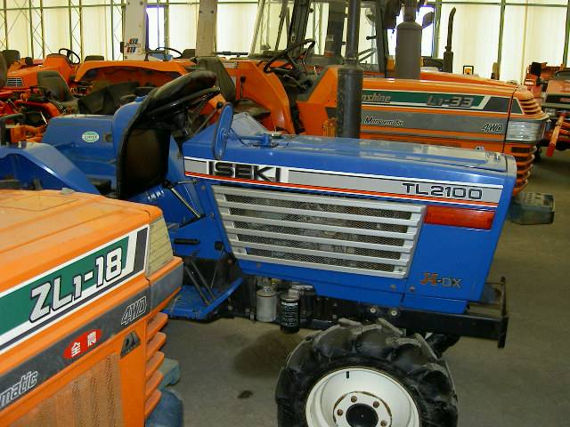

There has to be and expert Iseki dealer who has had both TL and TU series Iseki tractors out there. I am looking at a couple of Iseki's one is a TL2100F and one is a TU2100F. Does anybody know any specifics? from the photos they appear to be very similar.
See attached photo of TL2100F

See attachment of TU2100F

The short answer is the TL is slightly larger and has a nicer dash. The TL's such as a TL2100 take a Koyker 155 loader, the TU's, such as a TU2100 take a Koyker 110 loader. The 3-digit TU's, such as TU180 are a different breed altoghter.
We've recently sold a few of each. Nice tractors. The TU1900/2100 are essentially White Field Boss 21's.

The TL is a heaver built tractor and has a different steering system. I am sure there are a lot more differences. One of the other guys with a lot of experence could tell you. I think a lot of people look at the sheet metal and think they are the same.

TL has a flatter deck and is wider between the fenders. Also has external hydraulic strainer and other misc differences. Weight wise they are almost identical between the TL and TU.
