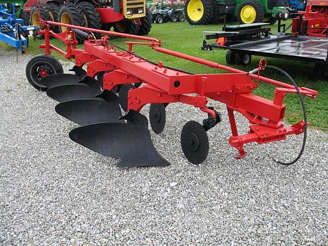

We have a field that was pasture for 15 years and we have been cutting hay off of it for about 10 years. It has ruts and holes from when stumps were removed 20+ years ago. What are your recommendations to smooth it out? I was thinking plow, disc and drag then reseeding the field. I have a older 2 bottom plow but I think it would be to small for the job. (time wise)
I have a line on a nearly new International 710 4 bottom plow for sale very cheap. What should I do? Here is a pic of the plow.
   / What is the best way to smooth out a rough field? #2
Does the field have very many rocks? If yes, that is not the style of plow you would want due to they will constantly trip and need to be reset. If it is rock, I would look for a spring reset model.
Other than that your idea is sound to plow it, disk and drag.

With the Kubota M9540 I think I will have plenty of tractor to pull the 710 as deep as I want to, it is a 4/18-5/16 plow tractor. The plow is a 4/16, I have a 10ft International wheel disc with a 12ft well casing for a drag that is VERY heavy, I think that this will work out for me. There aren't that many rocks here. Also a spring reset model adds about $500-$800 to price. I just wanted other opinions. What time of year is the best to do this? I am thinking now...we just finished our third cutting of hay. Thanks for the response.
