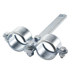

I am running hoses from a rear hydraulic kit to a FEL grapple. I want to solidly mount the quick disconnects on the FEL. They are flush face. A bracket like this would be great, but I haven't seen one for flush face conns:
I have seen setups with a simple L bracket. It looks like the NPT fitting are tightened down on the bracket. I'm not sure I can get the bracket thickness and torque on the NPTs right attempting this.
The QDs on the JD supplied hydraulic kit have grooves for retaining rings, and those rings hold the rear QD on their bracket. That would be great, but the flush face QDs that came with the grapple (Dixon brand) don't have grooves. I doubt that the QDs I am getting from Surplus Center will either -- and these are the ones that I want to mount so they don't flop around with or without the grapple attached.
Any advice is appreciated.

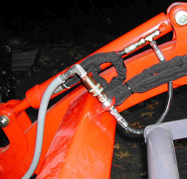

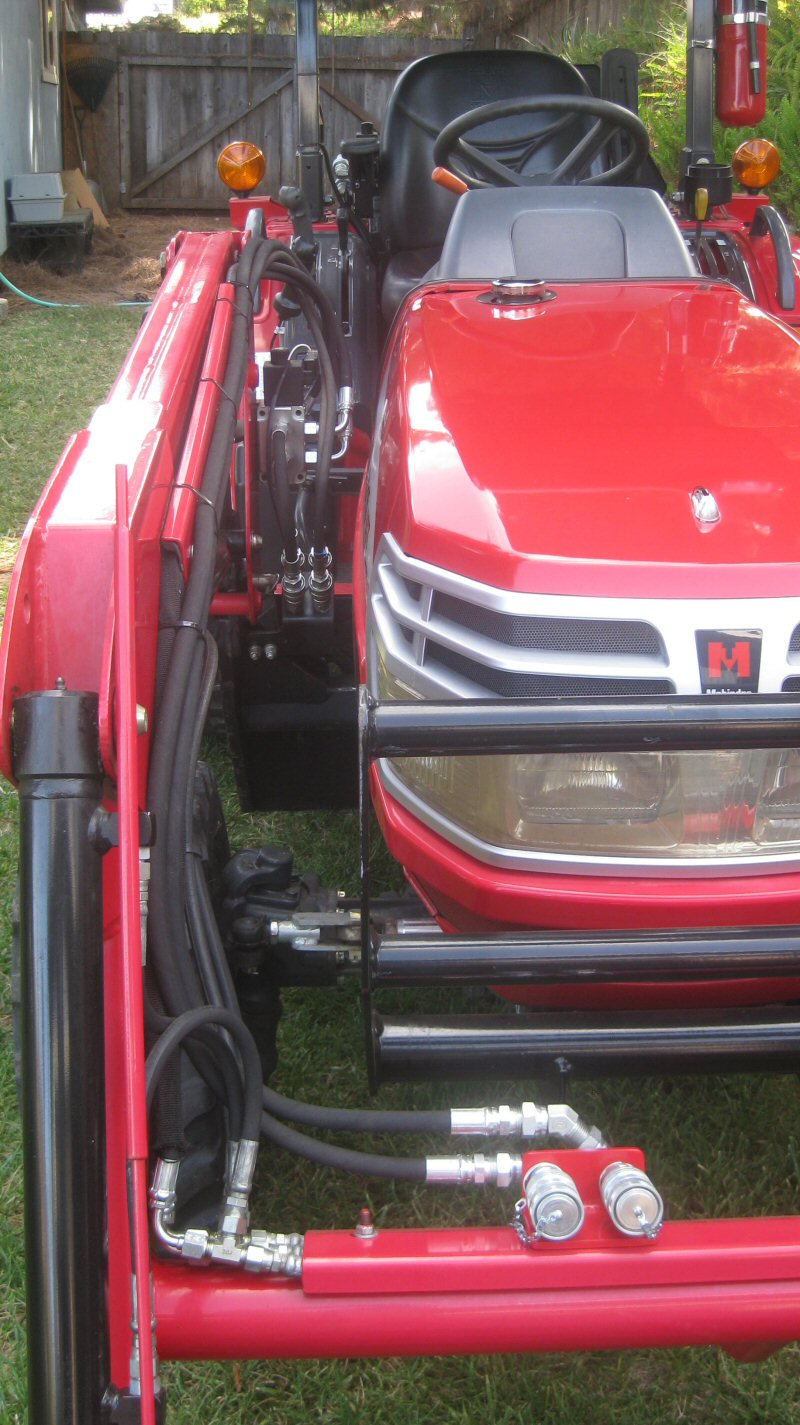

Here is how they are on the L4240
   / what is the best way to mount inline flush face quick disconnects? #5
   / what is the best way to mount inline flush face quick disconnects? #6
How the heck you keep that tractor so clean? Do you use it or are these old pics?
It was a few days old then. Note the dirt in the grill:D
