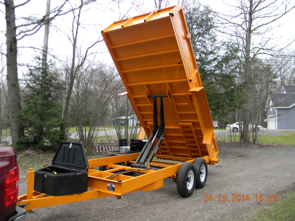

I just bought a 16' dump trailer by Cross Country Trailer. Its 13,800 GVW with a 10K capacity. It uses a single cylinder with scissor lift. I got the 16' to haul my tractor in if needed. It won't fit in a 14'. As mentioned it is power up and power down. Just got the plate and reg. the other day so haven't used it yet. Planning on using this week to get some bank run and then some gravel for my driveway. The trailer manufacturer told me that the scissor lift is all they use on larger trailers for the leverage advantage. A previously owned K3500 dump truck had a similar single cyl. scissor lift. I don't know if its the best set up. Like mentioned, all mfg. will give reasons why their type set up is best.
