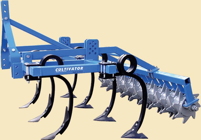

I have an old coil spring cultivator similar to the front bar of the one shown on the attached image. I think it is an old Deere because of the faded green paint. The narrow straight shanks as shown on the front bar of the image easily dig up softball-size rocks and with a couple of passes will bring soccer ball-size (or larger--I can't lift them) to the surface.
I use it to smooth rough sections of my walking paths, and also used it to work up a neighbour's riding ring. Another neighbour borrowed it to work up his riding ring.
It is very easy to bring the rocks to the surface but the hard part is handling them from there. I have a heavy duty landscape rake which helped but it still required much hand picking and loading into the bucket. I'm sure there are better ways to do that part.
