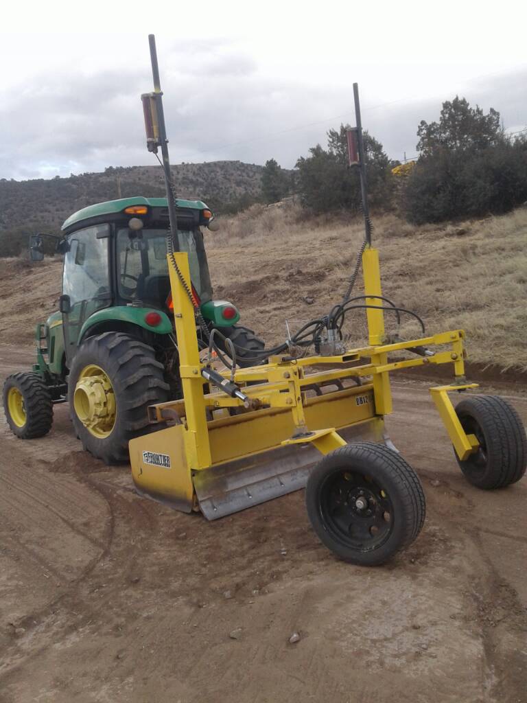

   / What is the Best Attachment for leveling 120 acres with 72hp 4x4 Tractor? #3
Also I have looked at the Box scrapers with wheels behind them. But I don't know how the finish grade would be.
This is what I see almost all the time now for land smoothing or leveling. For leveling or a specific grade, they use laser height adjustment. No laser needed for land smoothing, which sounds like what you are doing.
Long ago, we used an 8' wide one behind a John Deere Model A on 30 acres with good results. The land was disked first, then the scraper, and finished with a 10x30 wooden "float."

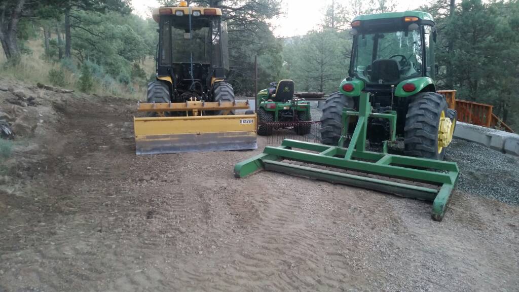

I do a lot of this kind of work and agree with others on using a disc first. Use a land plane grading scraper afterwards to quickly smooth everything out.
A box blade would also help with smoothing with or without wheels. I use mine for laser leveling with machine control. Not needed for your requirements.
Simply put a lpgs is the best simple tool for your smoothing project. Roller or culti packer afterwards then repeat with a lpgs will smooth the pastures quickly. 20151112_165734.jpeg20180324_175350.jpeg
