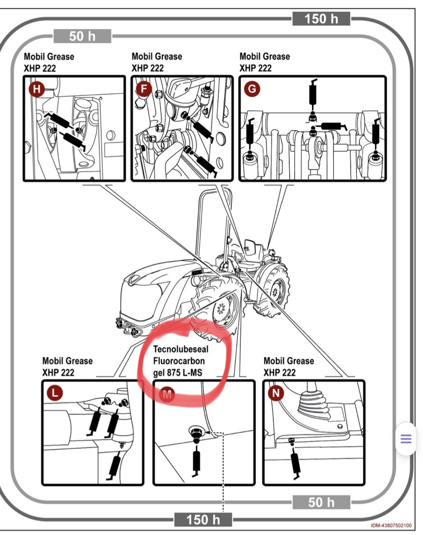

Hi guys,
i was just wondering if anyone knows what is so special about this grease that it costs so much 100 euros per tube (Ended up buying one tube from the ads for 50 euros).
The manual of my tractor, Antonio Carraro requires this grease for some of the zercs.
Tech sheet link
thank you

PTFE is a Teflon like material that is very slippery. It is used as the thickener in the grease and is considered as about the best on sliding surfaces. It is one of the new wonder materials.
Grease is made of three types of components
oil (mineral, vegetable, synthetic)
thickener (ie clay, lithium, PFTE)
additives (ie dies)

I don't know how critical that location is. Fluorocarbon greases do not mix well with standard petroleum lubricants. If using a grease gun you should use one which has never had another grease in it. When the two types of lubricant get together they kind of form little balls and the lubricity is lower than either lubricant on its own.

If you only need to lube that point every 150 hours, a tube of the special grease will last a long time. Since they recommended a different grease for every other point, I'd assume that the engineers know what they are doing and you really need the expensive stuff for this one point.
