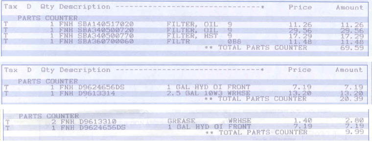

I did my 50 hour (and 100 and 150) service myself. I have attached an image showing the receipts for the parts I needed to do the 50 hour service. I bought enough oil for two oil changes (50 and 150 hour). I bought two tubes of grease for the zerk fittings and at 176 hours I am still on my first tube. I wanted to make sure that I had enough NH134 Hydraulic fluid so I bought two gallons of that and still have about 1/2 gallon left. Total cost was 99.97 plus tax which made it 105.97 for the parts.
I am glad I have done it myself, I was a little leary but it has made me all that more familiar with my tractor. The 100 and 150 hour services both went smooth and just tonight I was looking to see what I have to do for the 200 hour service. I am racking up way to many hours on a machine I just bought December 29th. My dealer couldn't believe I was almost ready for the 200 hour service. He said that it is better to be using it than to pay all that money and just have it sit around, I tend to agree.
