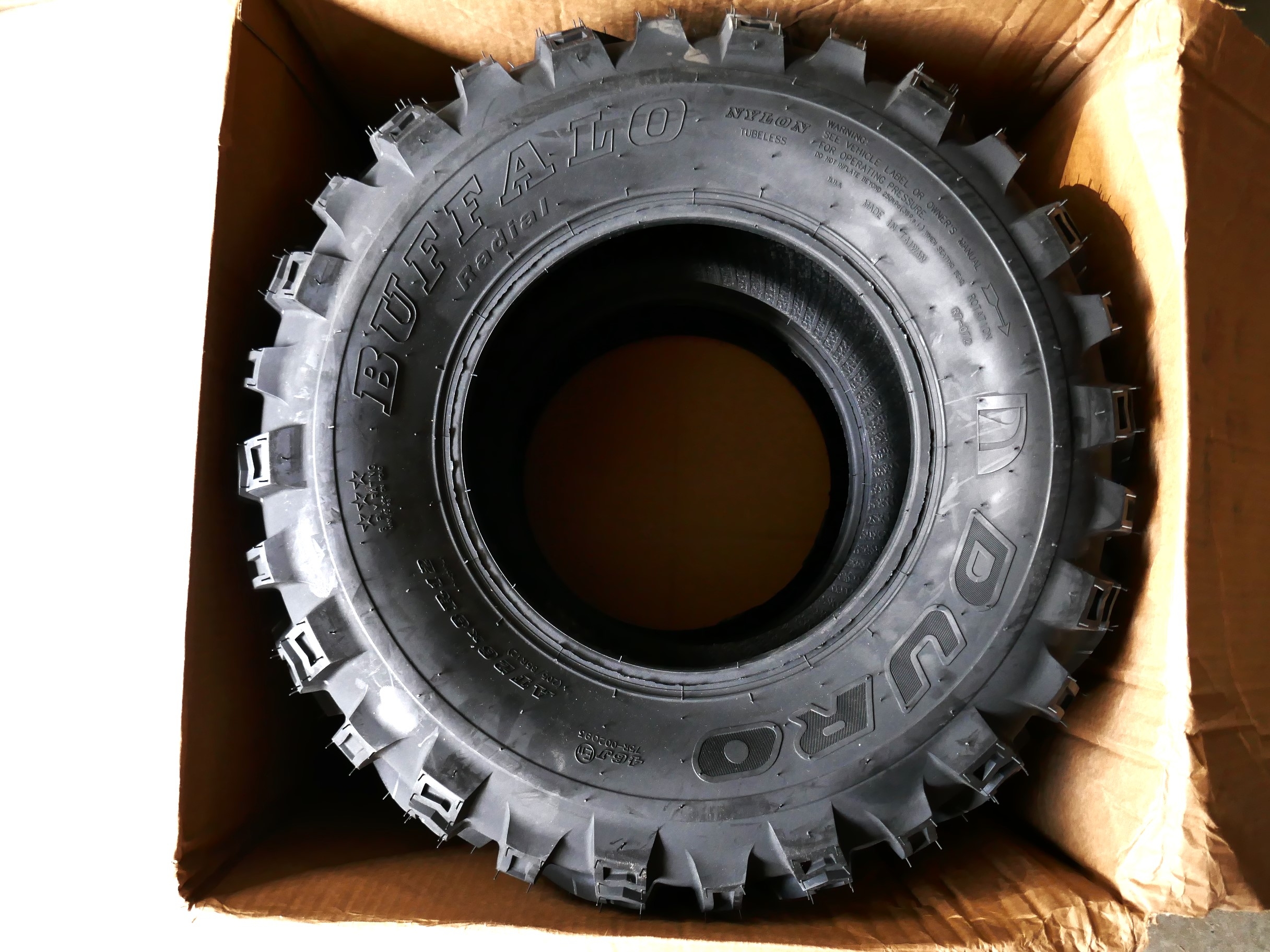

I purchased on-line a pair of front tires for my old 2007 Polaris Sportsman 500 4-wheeler. There wasn't much selection for the size I needed. They came in today. They were marked as 23X8R-12 6 ply nylon tubeless radials. The nylon surprised me. What is the significance of them being nylon ? My biggest question is can they be repaired with a standard tire plug or do I need something special ? I am just an old guy putting around in my woods so durability and handling are not a big concern. Thanks.

Nylon just refers to the material in the belting, aka steel-belted radial. That was a less expensive alternative in the early days of radial tire development, I think it may have been pretty much done away with by the dominance of steel belting, but hopefully some tire guys can chime in with more info. Check the date codes, those could be NOS from the early days.
   / What is a Nylon Radial tire ?? #4
I like tire patches better then plugs but plugs are faster to install...just my 2 cents. You can get a plug/patch combo also.
   / What is a Nylon Radial tire ?? #5
It's likely a nylon bias ply tire, which is pretty typical for UTV tires. Yea I know it says radial on the side. But the company's literature doesn't mention radial while they do for other models. Most UTV tires are nylon bias ply.
Either way you can plug or patch it like normal.
