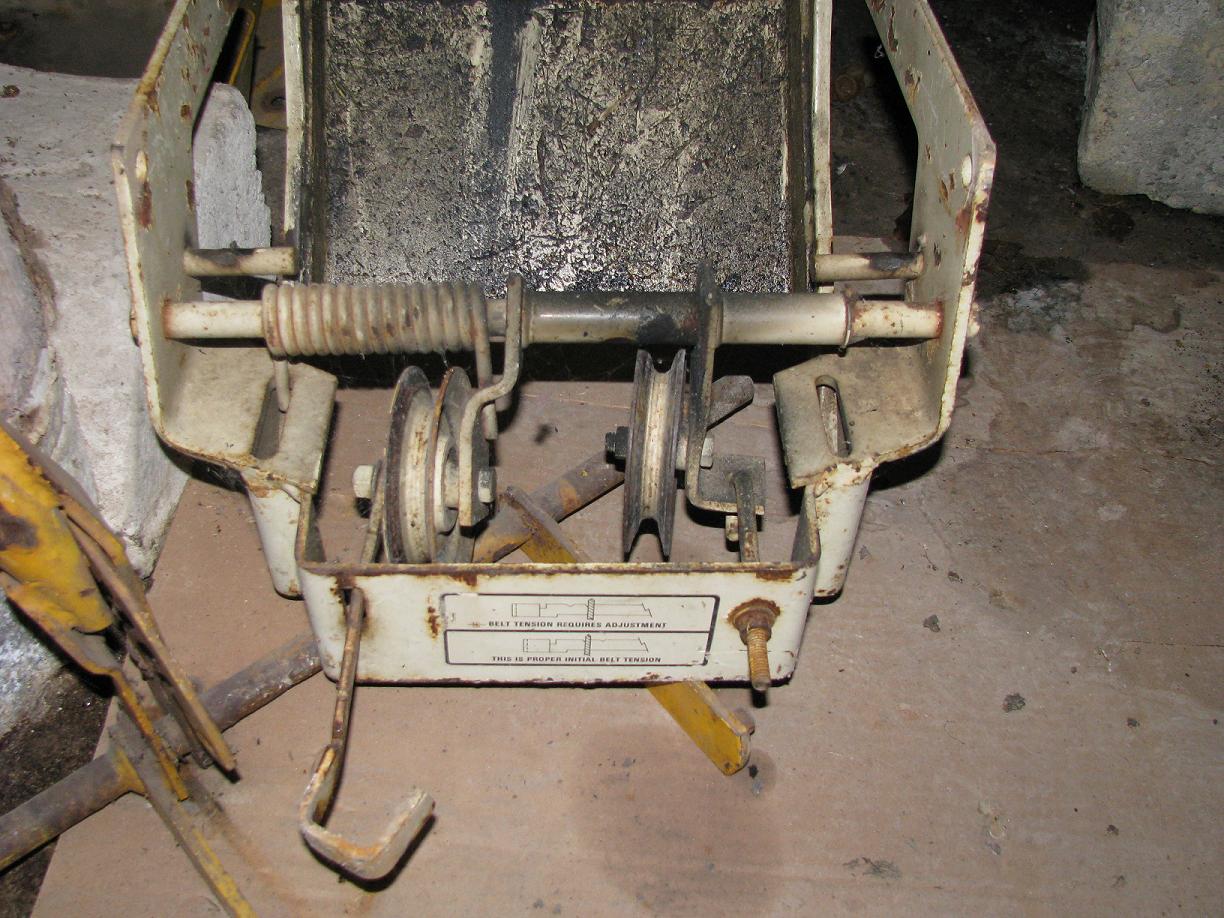

The mule drive is just the part on the front of the sub frame. It has 2 pulley to turn the pto belt 90 degrees to reach the mower deck. It is located directly below the pto clutch. The rest is the sub frame. I'll see if I can get a pic.

Mule drive pic

That sure looks familiar. Former 1872 owner.

Thanks for the info and the pic! :D
