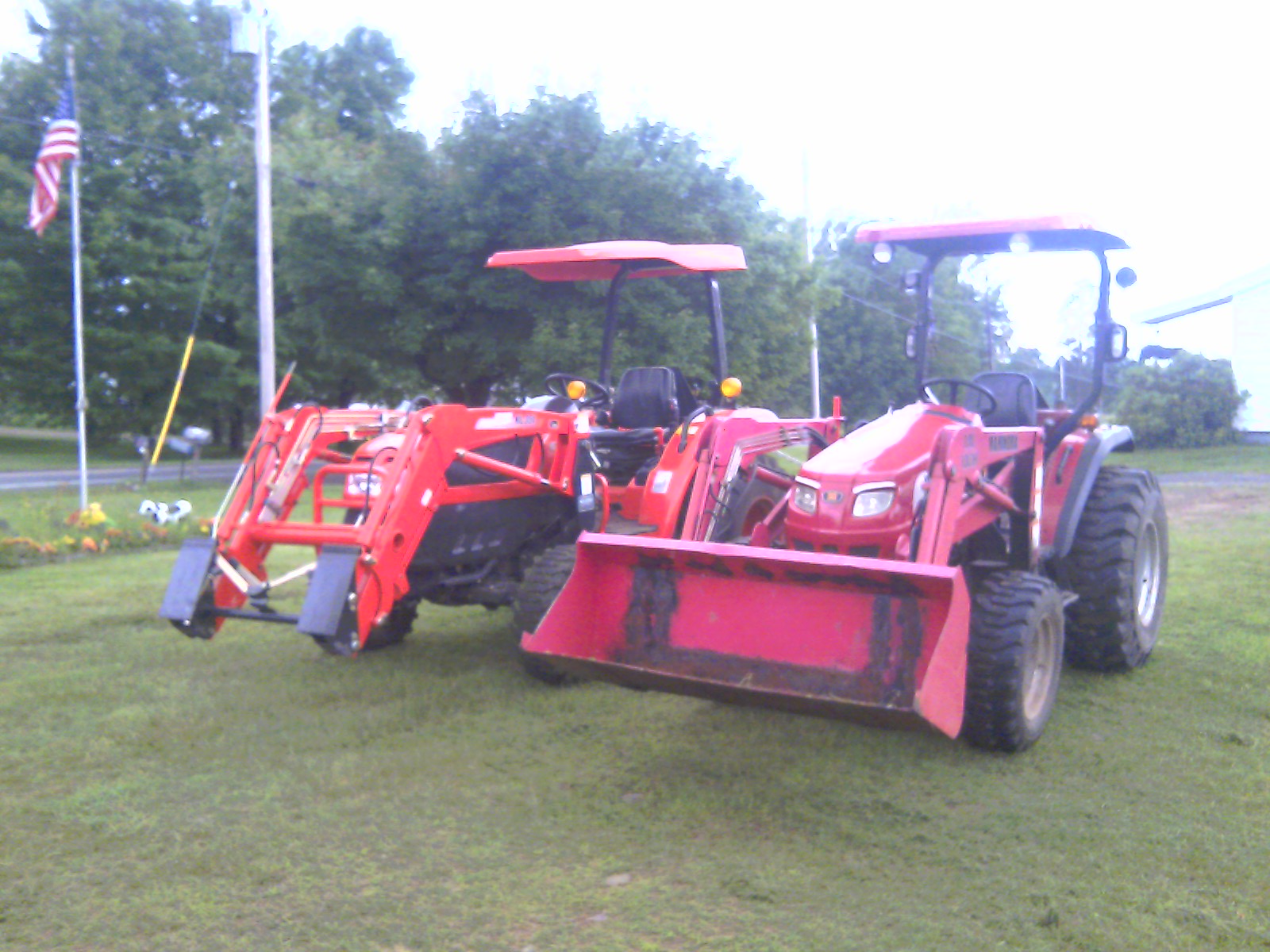

We now have a total of 3 Kioti HST's in our family now, 2 DK35SE, and 1 DK45SE We love em! Only thing i have found that limits my tractors work is #1, my imagination, and #2, my bank account. Don't under estimate the strength of a Hydro-static transmission. Here's a picture of my 2 HST's . . .John
