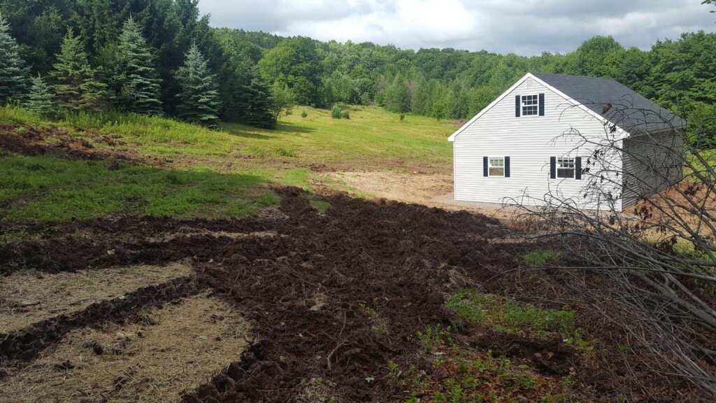

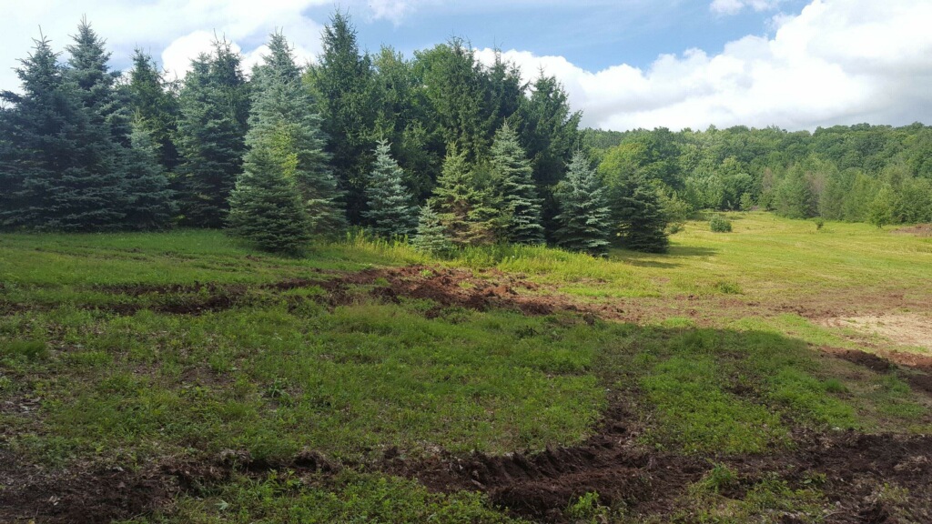

What Implement would you use to clean up these ruts?
   / What Implement would you use to clean up these ruts? #2
I'd just back drag-em. Not worth the hassle of hooking anything else up. If I had an extensive area rutted like that I might drag harrow or combo disk and drag harrow.
   / What Implement would you use to clean up these ruts? #3
I would just spend some time back dragging with my bucket..
   / What Implement would you use to clean up these ruts? #4
Back drag the FEL. Baling wire a piece of pipe and chain length together and drag it. How often do you want to repair this?
Did you build in a hole? Might need to plan on some contouring or terracing or something.
   / What Implement would you use to clean up these ruts? #6
I would just back drag those with the bucket too.
   / What Implement would you use to clean up these ruts? #7
York Rake and bucket.
   / What Implement would you use to clean up these ruts? #8
Same as above. Grade with bucket. If you are good with the loader, you can grade/fill going forward and smooth by back dragging. Work your way from the furthest point back. I like to gently scoop up the ridges first, fill the holes, then back drag the ruts parallel to the way they run.
   / What Implement would you use to clean up these ruts? #9
Seriously, did you build in a hole? I live on a rockpile within driving distance of a near desert. In the last ten years, all of newyork state received at least 3 times the rainfall I did. Some years and cities far more.And, you have dirt!
Doesnt water run in your overheads or wash that beautiful topsoil down?
   / What Implement would you use to clean up these ruts? #10
Harley rake. It would fill, smooth, and level the ruts in one pass - and would leave the surface ready for seeding.
