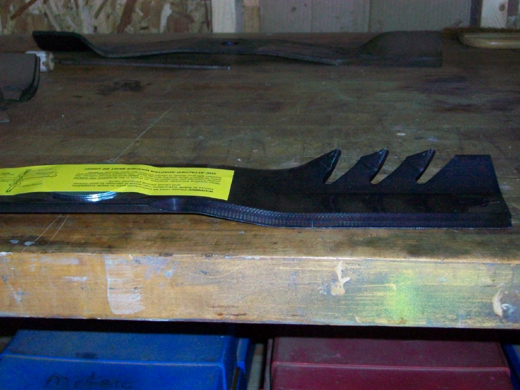

Bought replacement mower deck blades from the local JD dealer... They are not the same as the original blades. Among other small changes, they have "tearing teeth" on the top side of the blades. Well... that brought the blades closer to the plastic mulching body that is on the underside of the deck, and the right-hand blade was rubbing the plastic (very loud noise). The REAL problem was that the original mulch kit installation hardware includes a flimsy steel piece 3/4" wide by about 2-1/2" long that mounts underneath the deck and holds the plastic mulch shell up... and that was allowing the mulch shell to drop down by about 3/16" of an inch. I bent that steel piece a bit in the vise and re-installed it. Now the noise and rubbing is gone, but I'm betting that it will happen again because it's pretty flimsy. Meanwhile, I removed that blade and used my bench grinder to remove about 3/16" of material from the two outside "teeth" on top of the blade. I'm not really sure what benefit those teeth provide, anyway.

Sounds like the dealer sold you Gator Blades instead of JD blades. The Gators are great and largely eliminate the need for the mulch kit. However, it may be that they are not compatible with the mulch kit. I don't have the mulch kit so I don't know.

True Gator blades, or gator type blades, are not designed to be used with a mulch kit. Oregon has stated that many times over on various forums. If the blades you bought are green (though some do come in black) and have a hump in them just inboard of the teeth, they are made by Sunbelt (a JD company) and are nor true Gator blades. They suck IME.
The original Gator blades made by Oregon aren't any better since they don't have enough lift. However, the newer G6 and G5 Gator blades are a different animal and have a lot more lift (they are classed as a high lift blade). They work pretty well in most conditions, but not with a mulch kit. The OEM wavy mulch blades that come with JD mulch kits are the correct blade to use with the mulch kit installed, and actually cut quite well with the kit removed. I normally keep the OEM wavy mulchers under the deck for my 4115, even without the mulch kit installed, and it always cuts very cleanly and does a good job.
As others have said- use a bungee chord on your draft arms when no implement is installed. Mine have come with a black rubber bungee already on the arms.
The blade in the pic is a true Oregon Gator blade of the G6 variety-
