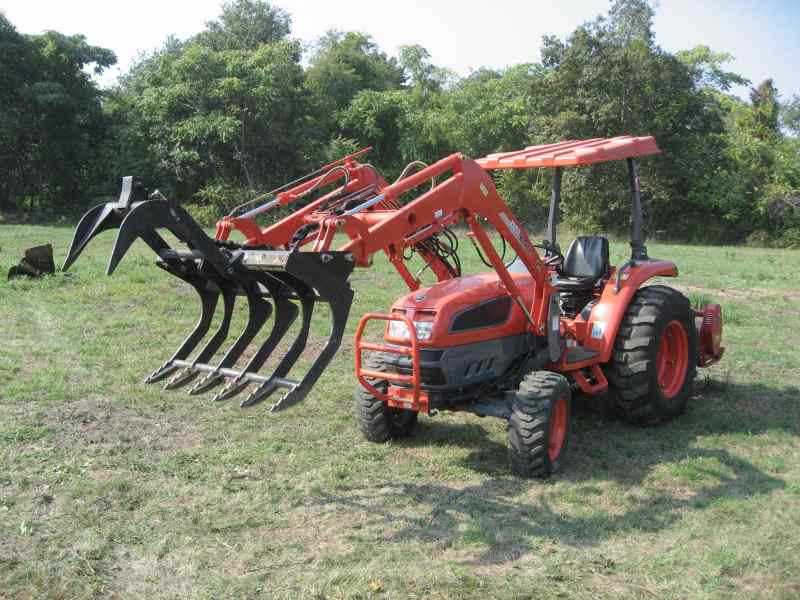

I wouldn't focus so much on brush vs rake as virtually all grapples can do either. The bigger choice is between what is commonly called root rake or "traditional" grapple (like the one in my avatar) and a clam shell style. Again, both can do the same work and each has advantages to consider.
The traditional root rake grapples from WRLong (OBG style) or from other manufacturers (Markham, ATI, various other skid steer implement companies) are generally less expensive than the clam shells. The traditional grapple allow you to scoop something up like a rock or log and just hold it with gravity. The clamshell can only pick something up by clamping it with hydraulic force. The clamshells always have full length upper jaws which is convenient for scooping up small sticks etc. Traditional grapples can have one or two upper jaws. Both types seem to work equally well with brush, bushes, individual logs, rocks etc. I think you can probably load up a traditional grapple a bit more as you can take multiple "bites" without needing to release your existing load but I'm not sure that is an important difference. The traditional open bottom grapples have longer bottom tines which is useful for leverage in popping roots and permits a bit more curl than the clamshell allows.
I've never heard anyone who owns a clam shell style report on TBN that they wished they'd bought a traditional root rake grapple. Likewise, no one has reported the inverse and traditional grapple owners are also a happy bunch.
Another option is to just add a couple of upper arms to your bucket (I presuem 72 or 84 inch). That would be the least expensive solution and there are definitely a lot of bucket grapple fans on TBN too. The only downside of the bucket grapple, especially if you have a toothbar, is that the bucket sides interfer to some extent with your ability to carry large wide loads like logs or trees (but no problem with smaller amounts of those things).
I have a loader that is pretty close to the one you have in capacity (2700lbs at pivot pins) and I have a 48 inch light duty traditional grapple. I'd say that either that size or one size up, the 60 inch would make sense in either clamshell or traditional style. If you read the grapple posts recently you'll see that Markham has just introduced a very solid 60 inch traditional grapple for the fire sale price of $900 delivered. Don't even bother checking anywhere else if price is an issue. On the other hand, if price is no object it is easy to spend $3000 on a clamshell made with T1 steel or other exotic abrasion resistant steels. I tend to think those are only really appropriate for skid steer use commercially as it is awfully hard to do any real damage to or wear out a grapple.
You can easily run the grapple from your rear remotes. Probably the only issue to investigate is whether your remote levers are conveniently located so you can drop your hand off the FEL joystick and reach the remote lever without looking (like reaching for the gear shift on a car).

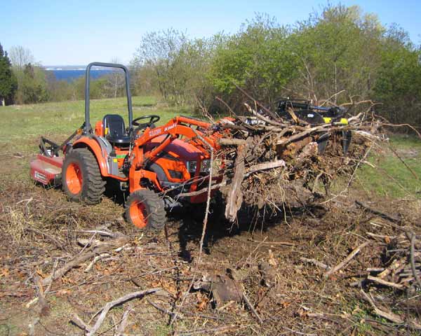

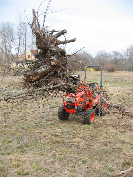

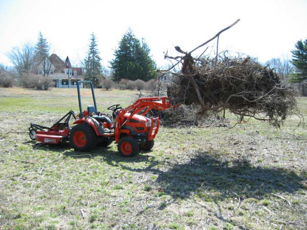

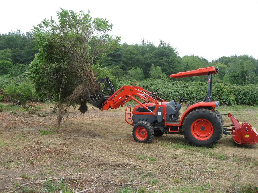

Yep. No issue I can see unless you are a contractor who is working the grapple hard 8 hrs a day. I have had my 48" light duty grapple (lighter construction than the Markham product) for three seasons now and have done a lot of aggressive brush clearing and rock moving. The grapple has withstood that without problem save for a few minor battlescars that do not affect function at all. If someone stole mine today I'd order a Markham 48 tomorrow. As noted, your loader may be just a hundred or two hundred pounds of lift more powerful than mine so I think the Markham 60 would be fine for doing the same sort of work.

Since I will be picking up trees and branches with mine, I chose the root grapple so that I don't have to slide anything under the brush piles. I will just open the grapple and lower it over the pile, then close the grapples and carry it away. If I had to scoop the piles first, I think that I will be pushing some stuff back into the trees that I'm trying to save.

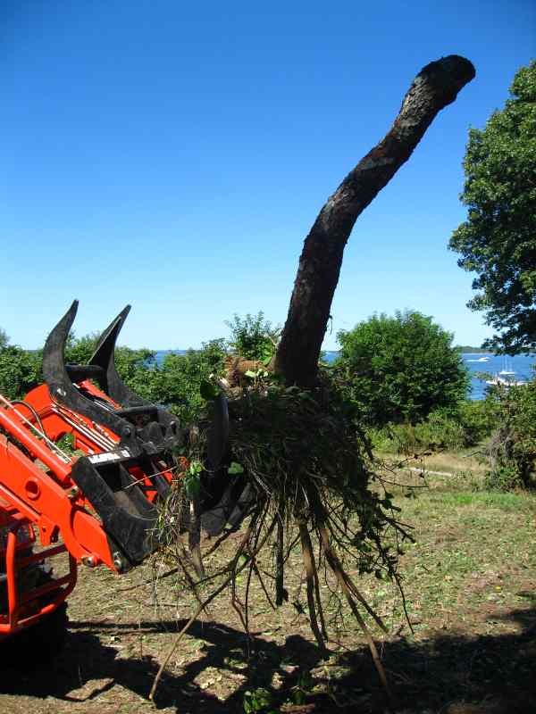

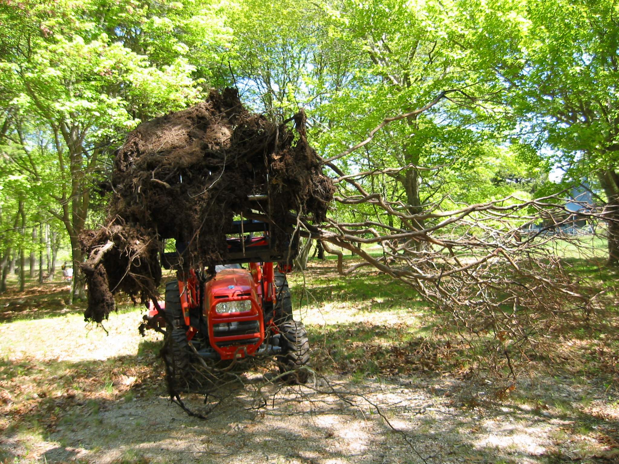

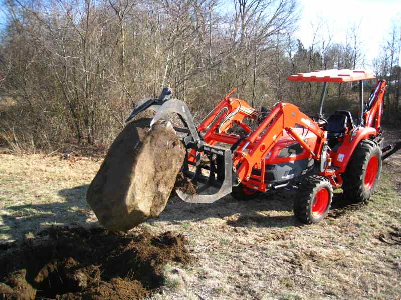

You are absolutely correct about what you said here. Take a look at these photos. Without a doubt, in each case, one of those rocks would not be clamped and fall out of my bucket. That last one is an extreme example.

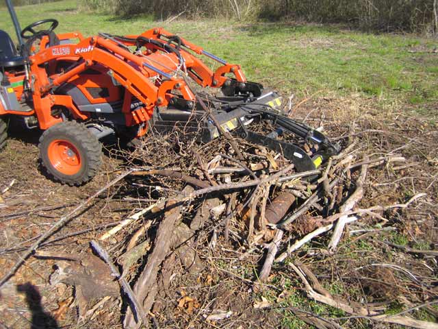

Although a log is one piece and can be held in one spot with little or no problem, it could twist inside your grapple if not held securely in 2 places. But it can be done and I know picking up a log with one jaw is a lot easier for that reason. Those rocks like in the above photos, where each needs to be clamped, I would be limited to picking up only one at a time.
Here are some log photos where the dual jaws are working at different clamp heights.

I think Eddie and Rob's comments are correct based on the pros of dual upper jaws vs a single long upper jaw as is found in clamshell grapples. There have been a couple of reports of damage to clamshells presumably with asymmetric loads on that top long grapple. However, I'd add that a single upper grapple such as found on the 48 inch style I have or the 60 inch from Markham do not have that vulnerability (nor do they have the broader coverage of the clamshell or dual grapples). For brush and logs there is no problem holding the material with just one upper jaw. Smaller sticks etc would be more of an issue. Asymmetric loads are not an issue with a single narrow upper grapple however as there is almost always a way to grab either the fat or the skinny side of the object, you don't need to grab both ends at once to have it under control. See photos.
A potential downside of dual upper grapples, besides the added weight and cost, is how you would load a small but heavy object like a boulder. Presumably it is not difficult to have one side of each upper grapple grasp something in the middle but that then leaves you with the same asymmetric forces on the grapple jaw that are potentially harmful. If instead you grasp the rock with just one of the grapples, then you have an asymmetrical load on the FEL itself which ain't good for the loader or tractor stability. For an example, look at the big rock I pulled out of the ground in the photos in my first post. I could not have done that, I don't think, with a dual grapple.
I don't want to confuse the OP with arcane details of pros and cons of different grapple types and would reemphasize and earlier point that no one with any style of grapple seems to complain much at all about any deficiencies. Any grapple is better than no grapple.:)
