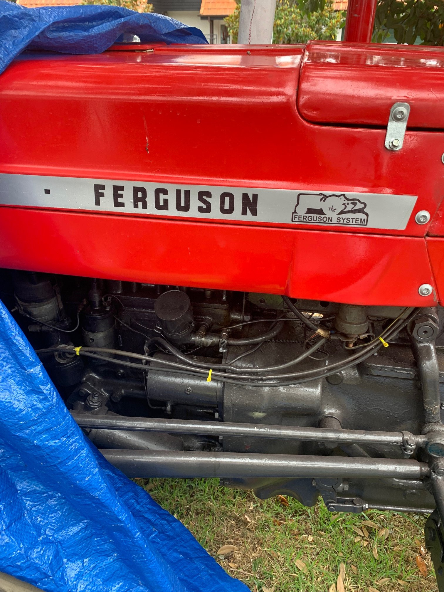

Hi guys,
I'd appreciate some expertise here. Trying to find out what to order. It looks like a filter of some sort... I'm just getting into this new found sport!
Thanks for the help :)
Momo
   / What filter is this? Massey Ferguson 135 Petrol #2
Where goes that pipe? To the air filter?
   / What filter is this? Massey Ferguson 135 Petrol #3
Is this a UK made 87mm standard engine?
   / What filter is this? Massey Ferguson 135 Petrol #4
   / What filter is this? Massey Ferguson 135 Petrol #5
Non-OEM oil filler/breather cap. Notice the pinched side and hose clamp on the bottom.
