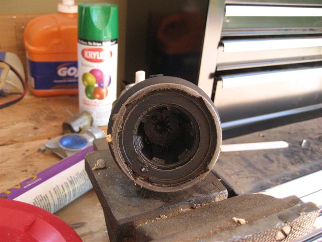

I'm pretty inexperienced, and have a question about my over run clutch.
I have the type that goes on with a shear pin through the PTO shaft.
I bought it 6-8 months ago and am just now using it. I lost the original pin that held it to the pto. So, I took a bolt and cut it to length. Slipped the bolt in place and put the set screws back in to hold it in place.
It doesn't come off the PTO, but it doesn't seem to be allowing overrun. When using the bush hog, if I put the tractor in neutral I have to wait for the blades to spin down before I can put in gear again. I'm thinking that the length of the bolt I cut is not right. :confused: Any ideas?
Thanks for any insight.
   / What exactly is a slip clutch and how does it work? #10
The bolt is not an operational part, it's a simple fastener. I guess you don't realize that an ORC only goes to work when the implement PTO shaft is caused to spin faster than the tractor PTO output shaft - like when using a rotary cutter on a downhill slope, or when the throttle suddnely goes from full to idle.
Putting the gearshift into neutral means nothing to the ORC, since the PTO drive shaft turns independent of the transmission drive shaft. All it does is buffer the extra RPMs when the spinning blades happen to make the PTO shaft turn faster than the tractors output shaft (like the downhill example).
