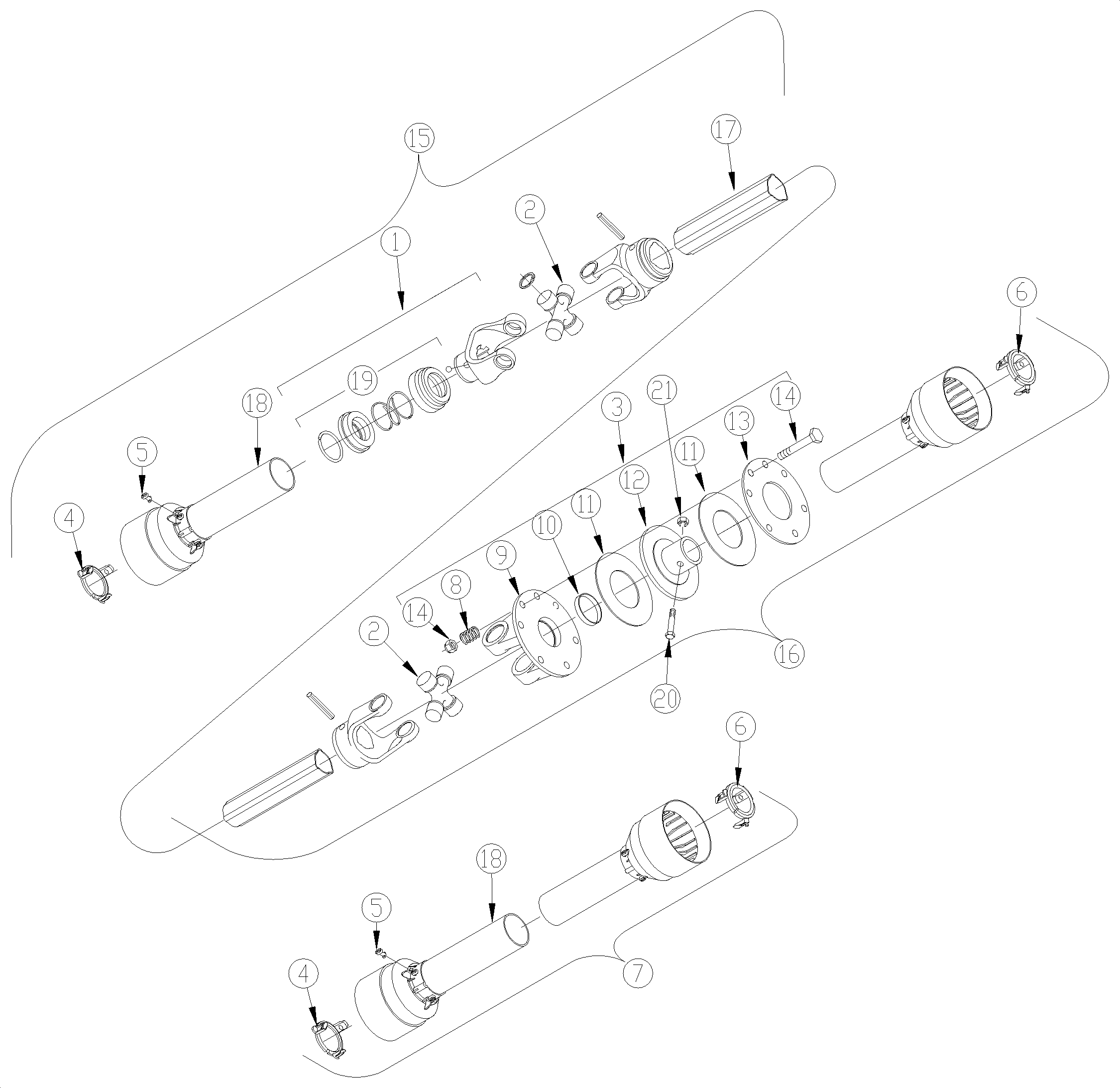

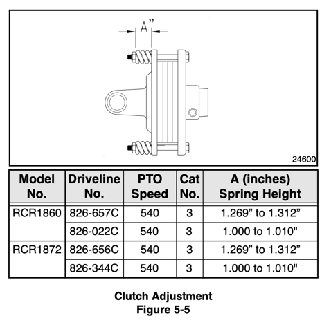

From my RCR1872 manual. How do I tell which driveline I have? I can't find any obvious indication on the unit.

I have a RCR 1872 and the manual and driveline sticker showed Part# 312-728A which replaces 826-656C. The chart I have shows the same spring measurements as the 826-656C.
