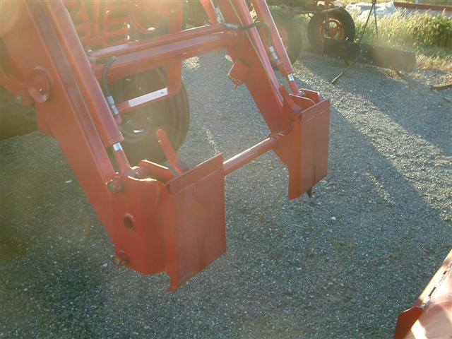

What does it mean when they say "Dual Hydraulic Outlets"?
Also - "Quick Attach Bucket"? Does the bucket come off the loader arms?

The Quick Attach Bucket would come off the arms....it would be similar to a Skidsteer type hook up where a plate would stay on the arms and the bucket would detach.
Very nice feature
As for the Dual hydraulic outlets....(which to me is phrased oddly) ..."should" mean that there are 2 extra hydraulic "remotes" available to add implements that need hydraulics to operate.

I believe they are talking about the rear remotes off which you can power hydraulic top link, batwing etc. Our M8540 has dual remotes and my L5030 only has one. (picture attached).
Quick Attach does mean the bucket will come off easily. Some are "skid steer" and some are not; go for the skid steer type.

I'm presuming that they mean a pair/set of remotes, but it would be great if they meant two sets of remotes! I use my remotes to rotate my snowblower chute in the winter and to operate the grapple on my grapple rake in the summer.
I agree that the skid steer type quick attach is the better choice (there are other types, notably Deere's), because the SS type is more widely used, so attachments that fit will be easier to find (and/or resell).

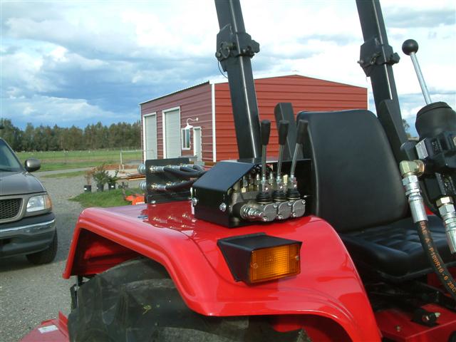

You need power beyond for a backhoe or anything that has it's own hydraulic control valves.
Some people are confused and will call a single SCV dual because it has two quick couplers. Dual SCVs will have four couplers, two for each SCV.
I like having both a quik-tack loader and bucket. I can quickly remove the complet loader or just the bucket.

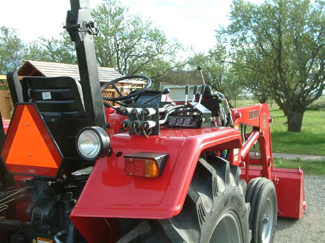

Here are the triple remotes on my Mahindra 5525

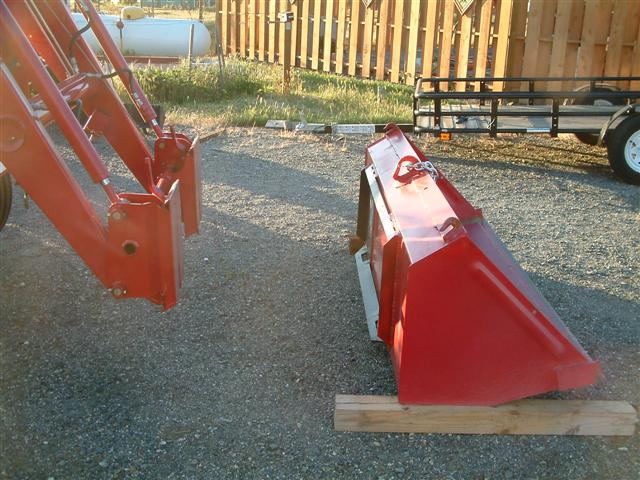

and here is the skid steer quick attach
Yes, the bucket comes off the skid steer adapter on the FEL arms so you can attach other skid-steer-compatible implements.
