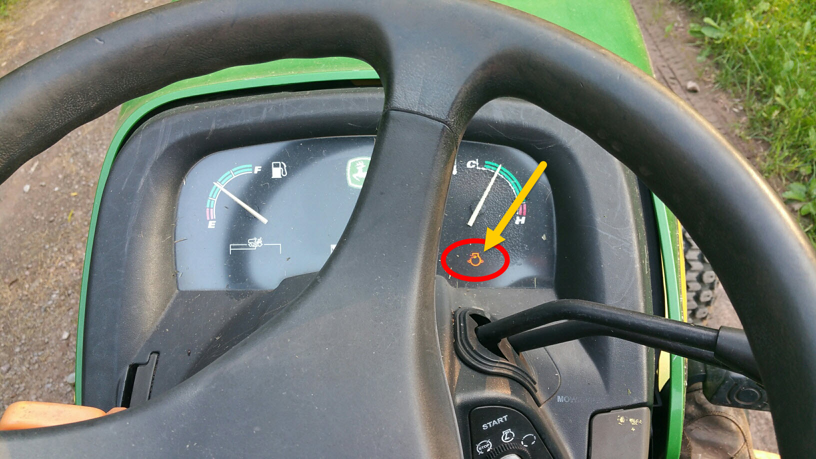

The light shown below has come on and is staying on and I can't find it referenced anywhere in the manual where all the other dash lights are described. Nothing seems to be out of the ordinary but it must be on for a reason?

Look in the operators manual under the "Operating" section, and under "Using indicator lights" where item D is explained
D - Air Restriction Indicator Light - will come on if air restriction indicator shows that air cleaner requires service.

Thanks Beenthere (and Bladehauler). I think you guys are right. I don't have the manual here but I'll definitely check that when I get back. As I just changed all the filters recently I guess I never thought of that as the problem. Been really dry/dusty lately and more than likely that was a contributing factor.

As a final note, it was indeed an issue with the air filter not being seated correctly. Took it out and reinstalled and the light went out and hasn't come back on. Smart fellers hereabouts. :thumbsup:
